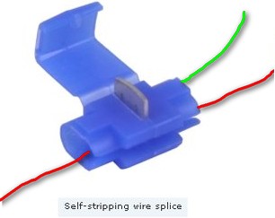

Originally Posted by mattyrayb
I assume the wire splice is one of these and assume the left one.
The left one indicating all I'd have to is stick the wire in and close it, correct?
And the right one looking like I'd have to strip the wire coating first and then put in and close?
The one on the left, would connect an existing wire (without changing source or destination of the wire) and allow another wire to tap into the source. For my illustration, the red wire is the existing backup wire. The green wire will go to the new backup light (preferably to the relay, but that is another discussion, involving power ratings, and thin wires, etc)

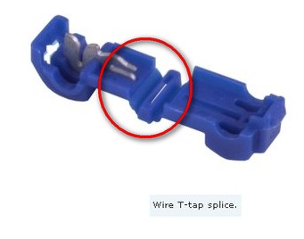

the one on the right, would be for using a connector. Essentially, you place a wire in the top half, and then it gets folded over for a connection. The bottom portion (see circled part) has a slice in the plastic, so that it can go over a connector.
Sort of like one of these
This can be used on the back of switches, or on the male portions of the previously mentioned connector.
