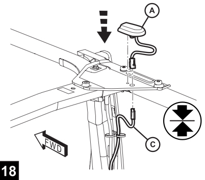

Here is where the factory one mounts, I installed mine here and have had zeros problems.
