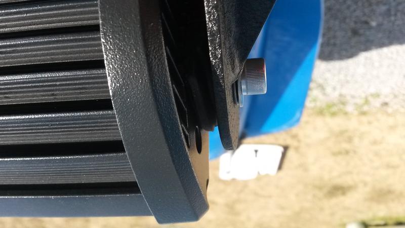

So I tapped the light to 5/16 drilled all the way through the end cap and removed enough metal from the housing so the bolt will tighten down without bottoming out. It seems very secure now I also added the rubber bushings that came with the light mount between the light and the mounts, she's very snug I'd be surprised if it falls off now.
To eliminate the wind noise which was pretty unbearable I purchased some campertop gasket from Napa cut it in half then folded it in half and inserted it between the bottom 4 fins this worked out pretty good.

I couldn't be happier I'm about 245$ into the light plus it gave me something to do
