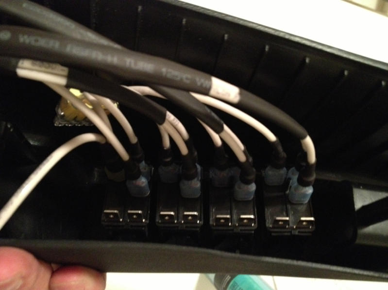

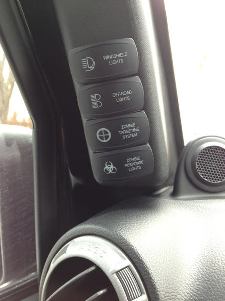

Did not check it with a meter yet. Hoping to do that today. But way easier then tearing into the dash and running wire back there. My other power ill use a fuse tap for. Rugged ridge a pilar pod looks good inside. The fit to the door needs some tweaking though.
This is the wiring and install do far. The switches are completely wired though before installing. Still have to run relay and mount the 130w KC Slimlites on windshield mounts.
