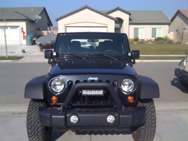

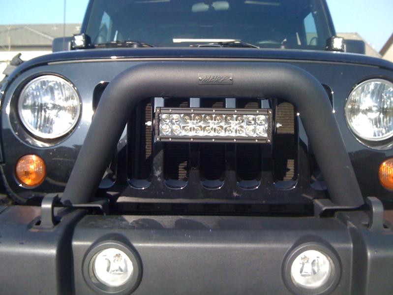

Hi guys. Update time again for anyone interested. Rigid finally got back to me and were pretty sure it's either the relay or other wiring issues. So to trouble shoot some more I pulled the light off the bull bar and set it next to the battery using gator clips to power the light. The light did not flicker when powered this way. So again I looked at the Rigid supplied relay pig tail and noticed the ground wires were about to come uncoupled so I took the relay out and soldered the wires as if there was no relay at all, plugged in the light and no flickering. The wiring should be just fine this way do to low amp draw and wattage. However, when I started to aim the light last night the flicker started again. When I snug down the driver side bolt (side with wiring) everything is okay. When I tighten the passenger side at all it causes a flicker! Pretty sad considering they are suppose to be so tuff. I emailed this back to Rigid last night. We'll see what's next!

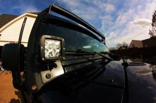

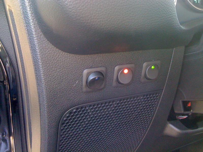

I have duallys, 50" & 20" & couldn't be happier with the lighting or customer service.
ID:	289535   Click image for larger version
ID:	289536   Click image for larger version
It looks awesome!!! I want the 50" but not In the budget at the moment sadly lol
Great looking jeep!
