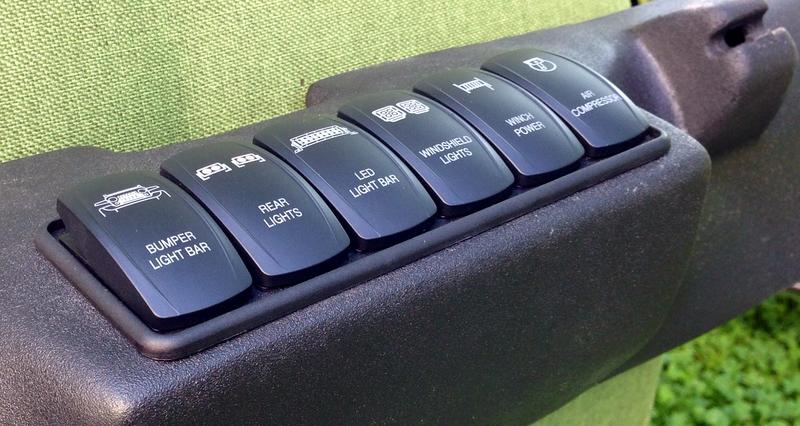

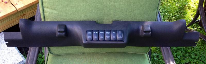

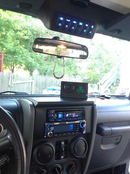

Thanks man never played with fiberglass might have to give it a try. Has anyone made a overhead console that still allows the use of the hardtop mounts on a 2012
Old Oct 29, 2014 | 02:26 PM
darkknight1999's Avatar
Joined: Mar 2008
Posts: 563
From: Hopedale, MA
Thats what I have. It fits perfectly, effects nothing and looks factory.

Beautiful wiring job Darknight!!

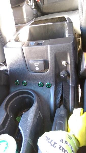

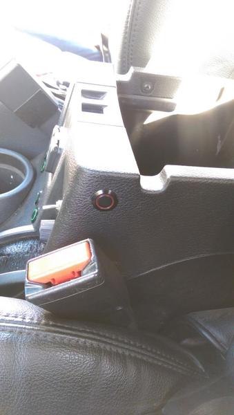

Any reason you want to mount them overhead? Depending on your model, you could fit at least 5, if not 6 switches on the front of your center console and tuck one or two on the side

Switches engraved with their function that are controlled by the factory panel dimmer, located where they can be read and easily used, satisfies the OCD in some of us. ;-)
