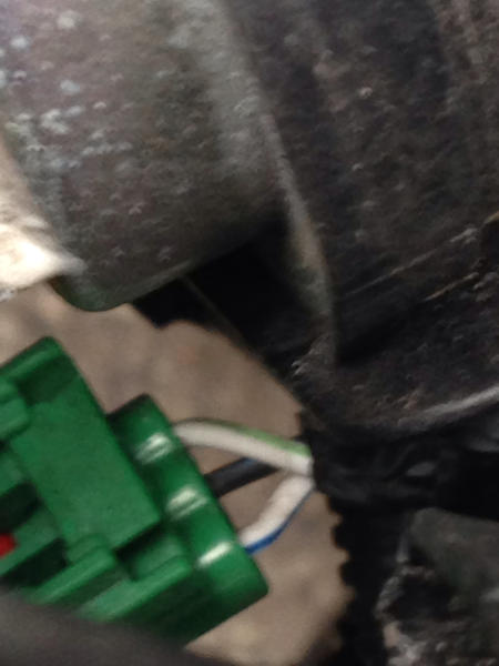

No white/gray to chose from.

Must be drivers side...white/blue on drivers side like it said in the thread.

According to the 2015 wiring diagram I looked at...
Left high beam wire = white with light green tracer.
Right high beam wire = white with gray tracer.

I just checked all the way back to 2008, and they are all the same as I posted, according to each year's diagram. I have not look at the wires on my JK to verify.
Are yours verified different from the above post?

No. In the thread I linked I said I believed it was the blue stripe. That was based on threads I had read. The passenger side is verified as I tapped that.
Edit: I updated the linked thread so I hope it is correct. OP please let me know if it is different from what I've read.
