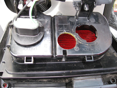

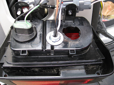

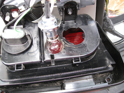

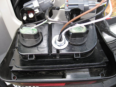

Sorry for the long delay. We were preparing for a trip to Baja and are there now. Here are some pics of the taillight installation. It does not require diodes and does not touch the Jeep wiring at all. The fit is tight for the bulb but was actually very easy to install.

For those seeing the pics of the tail lights drilled for the additional bulb... do know that this is not necessary! A simple non-invasive addition of a wiring harness (no diodes used) and you can set-up your JK lights for toad duty. Yes, you can go the additional bulb route but again not necessary.

It's a shame to see all these holes being drilled unnecessarily. You do NOT need to drill holes and install extra bulbs, nor do you need to use diodes. Please see the write up section for Blue Ox baseplate and wiring writeup.
