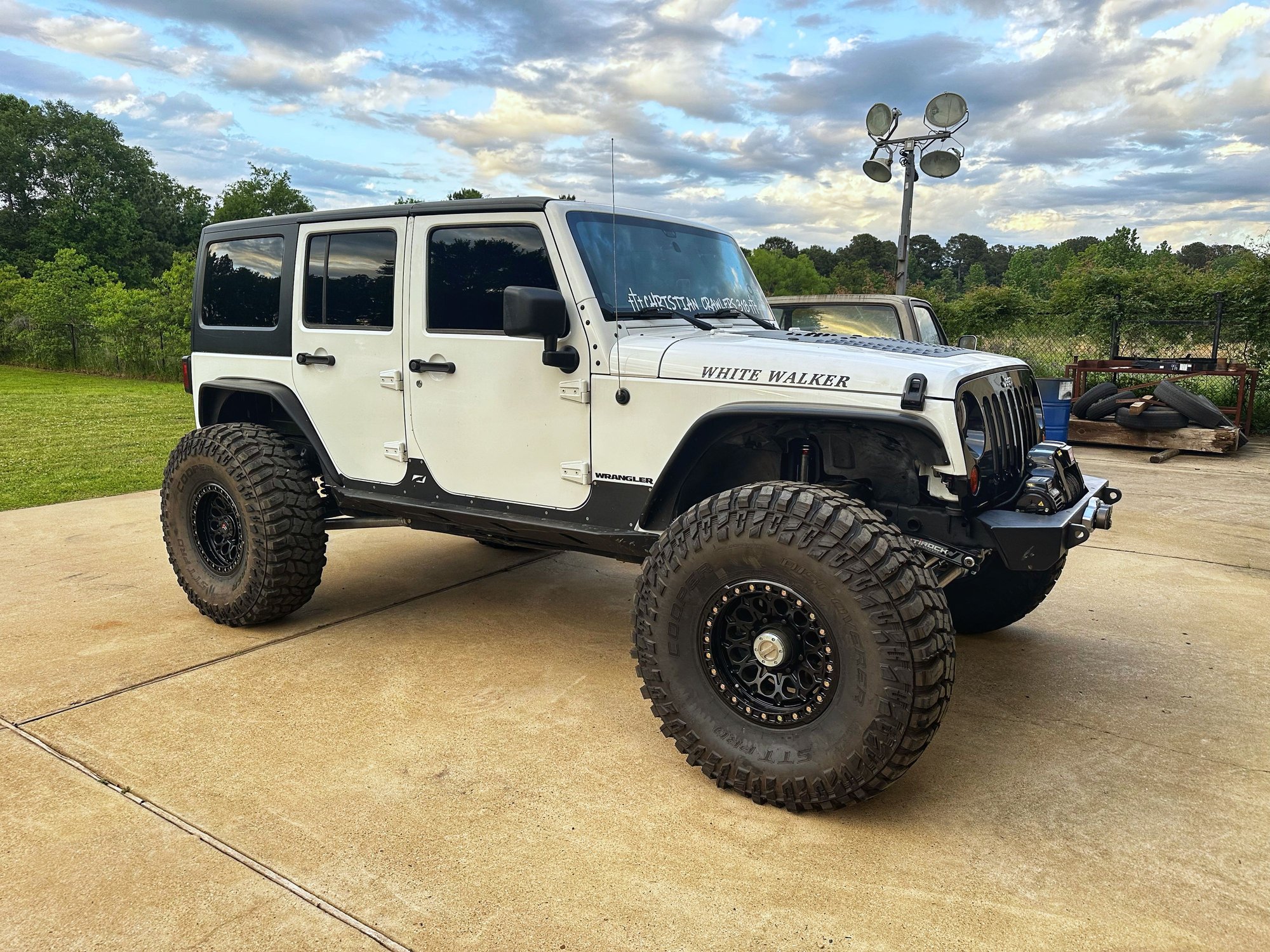

Cut about 5" off the bottom of the bumper. Put an RPM aluminum tie rod on and ditched the stock rubicon sway bar for an Antirock one.

Put Motobilt sliders & diff covers on, built me some fire extinguisher mounts, Installed hood louver & deleted the rubber bumpers & footmans loop.

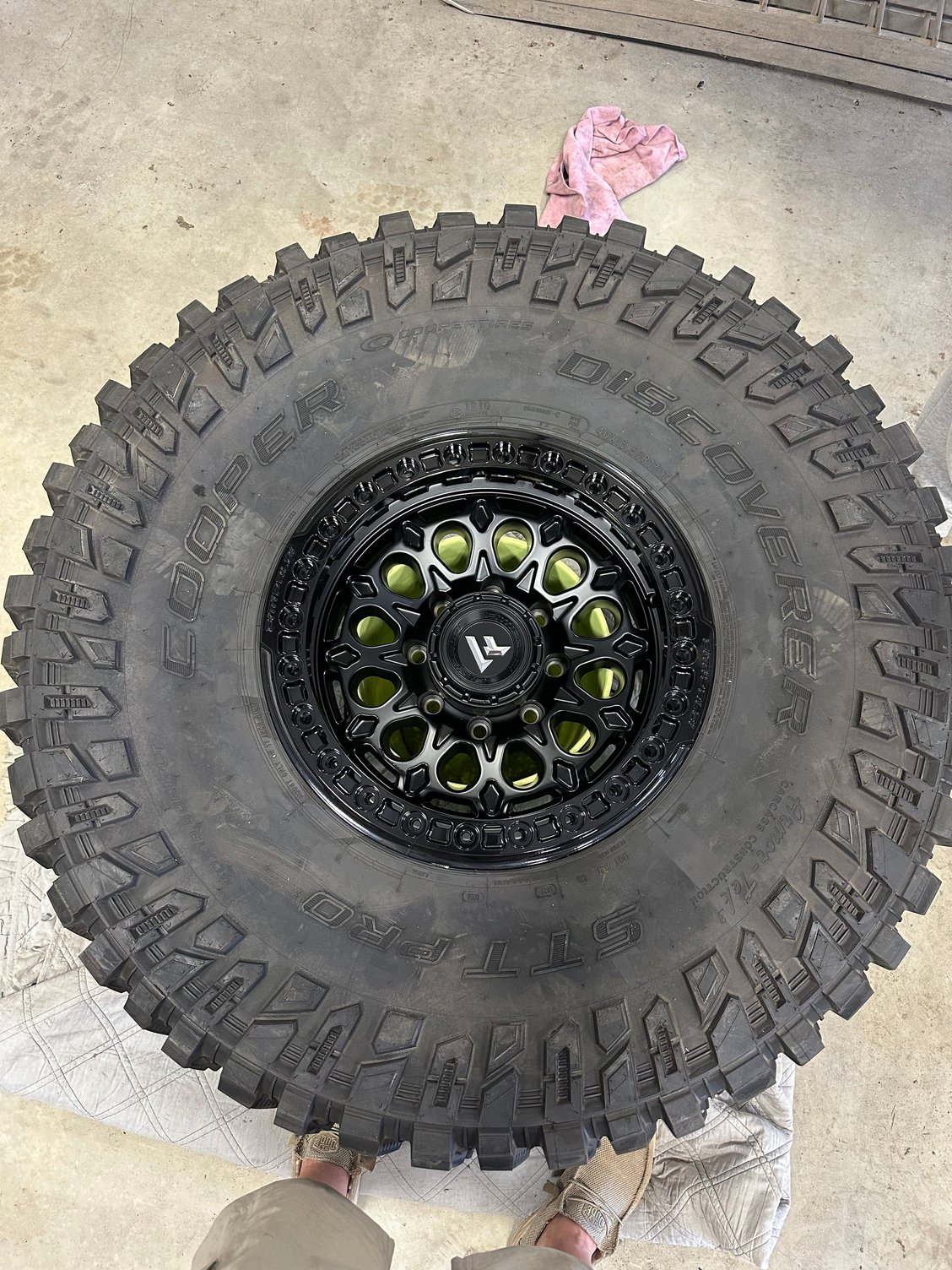

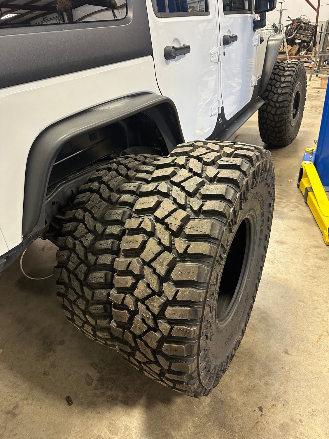

Got me some new wheels and tires. 1 tons coming soon.
