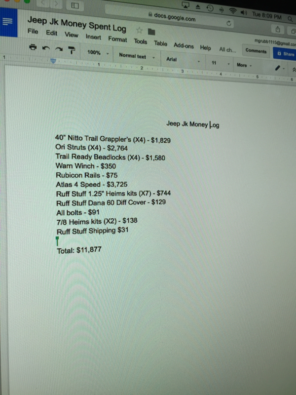

Over the last couple days i have order a lot of parts. Beadlocks, Ori's, atlas 4 speed, all heims for control arms and steering. Here's the money log I am keeping so I can see how much I've spent on the jeep. (All stuff on that list is ordered) Dirtman is right... I'm definitely going over budget. (Disclaimer*** The rubi rails are on the jeep now and when i do the axle swap, I'm going to make boat sides.) Click image for larger version
