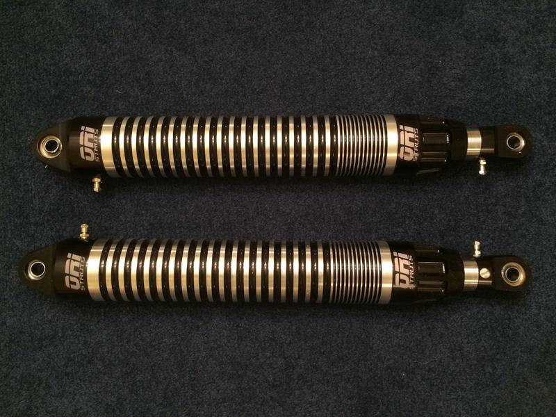

Probably a good time to provide some teaser to the build. Partial mod list:
- Axles: D60 and Sterling 10.5 off of a 2010 Ford F350 (72" WMS to WMS)
- Suspension setup: Double triangulated four link rear, 3 link front
- Stretch: 7" rear, 5" front (still hydro assist; wait for the magic)
- Articulation department: 16" ORI STX struts all around
- Gas tank: relocated to a sneaky place so that I can still use the rear seat and have storage
All fabrication done by me.
Attachment 582531
Looks like your going to have fun this winter, will be watching the progress.
Why the 10.5 over a 14 bolt or D80 in the rear, except that they came in a set.
I like the idea of struts and their tunability, the only disadvantage I have seen is if you blow a seal you have one collapsed corner.
