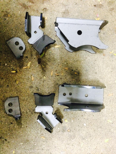

Got some parts in today. Too bad they're for my rear D44. The lower CA brackets were trashed and had a lot cut off, so I'm welding these super beefy Artec brackets on for the new owner. Artec makes some nice stuff.
