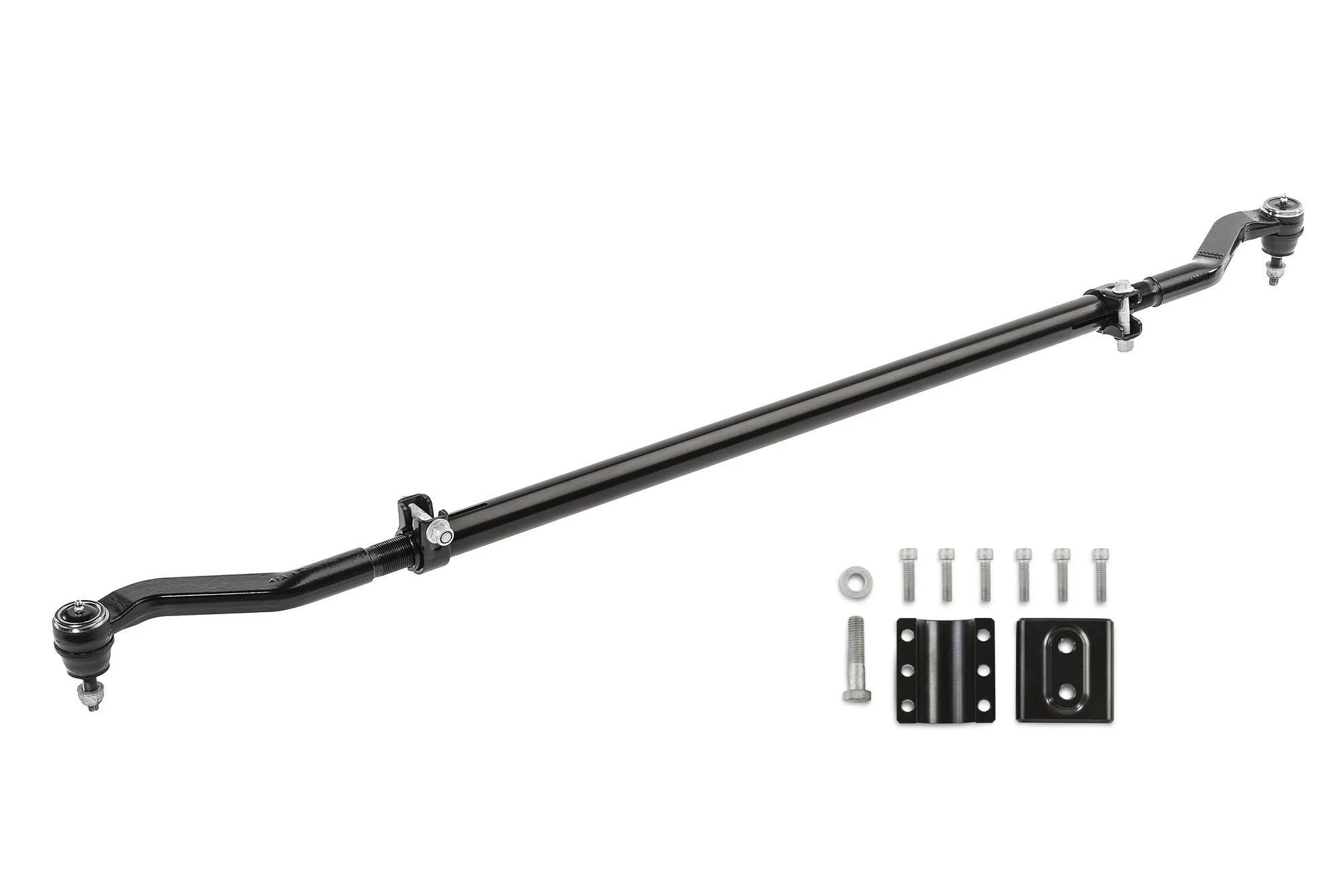

Well I had a little interference with the Tie Rod and cover. Used the 1 Ton offset ends but not enough room. Currie recommends the Yeti high offset tie rod part number 78065001 so will get one on the way. Looks like it is a beast of a tie rod! The Drag link worked out fine.

Naturally after I buy a 1 5/8" tie rod I get shoe horned into buying the more expensive Rock Jock bracket. But the tie rod is made from a nice tough 4130 cromoly which I like. Tom Woods driveshafts arrived and look great. Not to badly priced either.

So its on the road but working on a few little things still. I got the traction control light on and can feel it pulsing the brakes. I think my Super Chips Flashcal can delete that. It may be the sensors on the rear. They required a little modification to fit which surprised me. The Big Brake Kit is awesome. I have a check engine light on that I'll sort out today. Might be a wire not connected. The new front track bar bracket sticks outside the frame farther which now hits the stock Rubicon sway bar so need to work that out. I have not been a fan of it anyway. The Yeti tie rod is awesome. So getting closer!

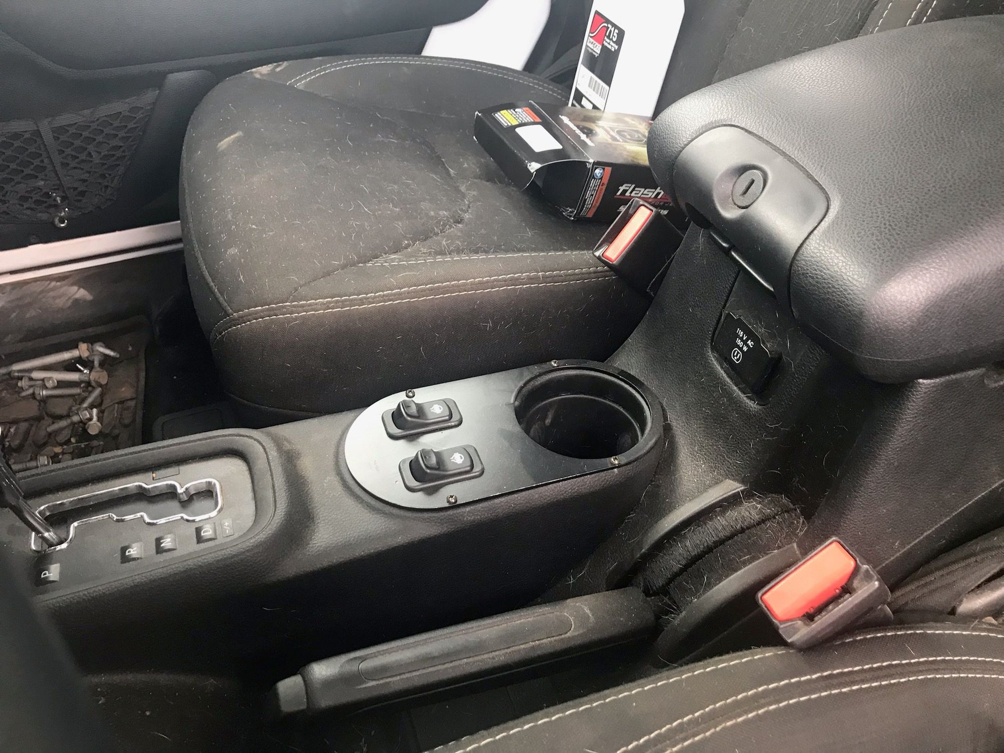

Well the Superchips Flashcal did not delete the traction control so still working on that. Jeep really needs a good cleaning sitting for two months. I sacrificed one of the cup holders for my Eaton E Lock switches. It was were I want them so I made a plate to install them there.
