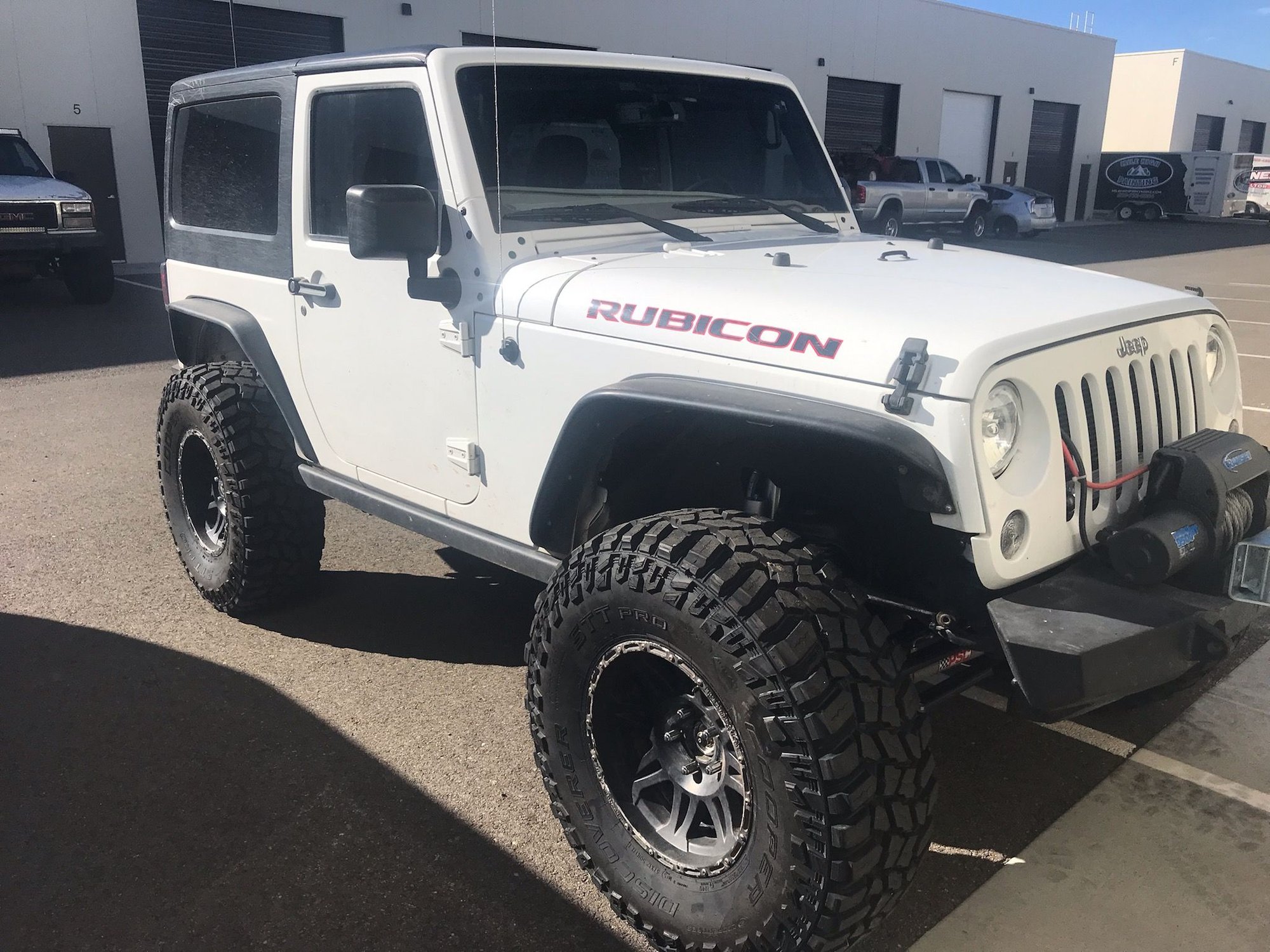

OK rolling on 37's now! Amazingly the 4" back spaced wheels seem to work so far. I'll need to trim the stock rock slider for clearance and trim the rear pinch weld but the front is non rubbing and looks good. After that minor stuff I'll do some flexing and bump stop adjustments.

Looking really good!
