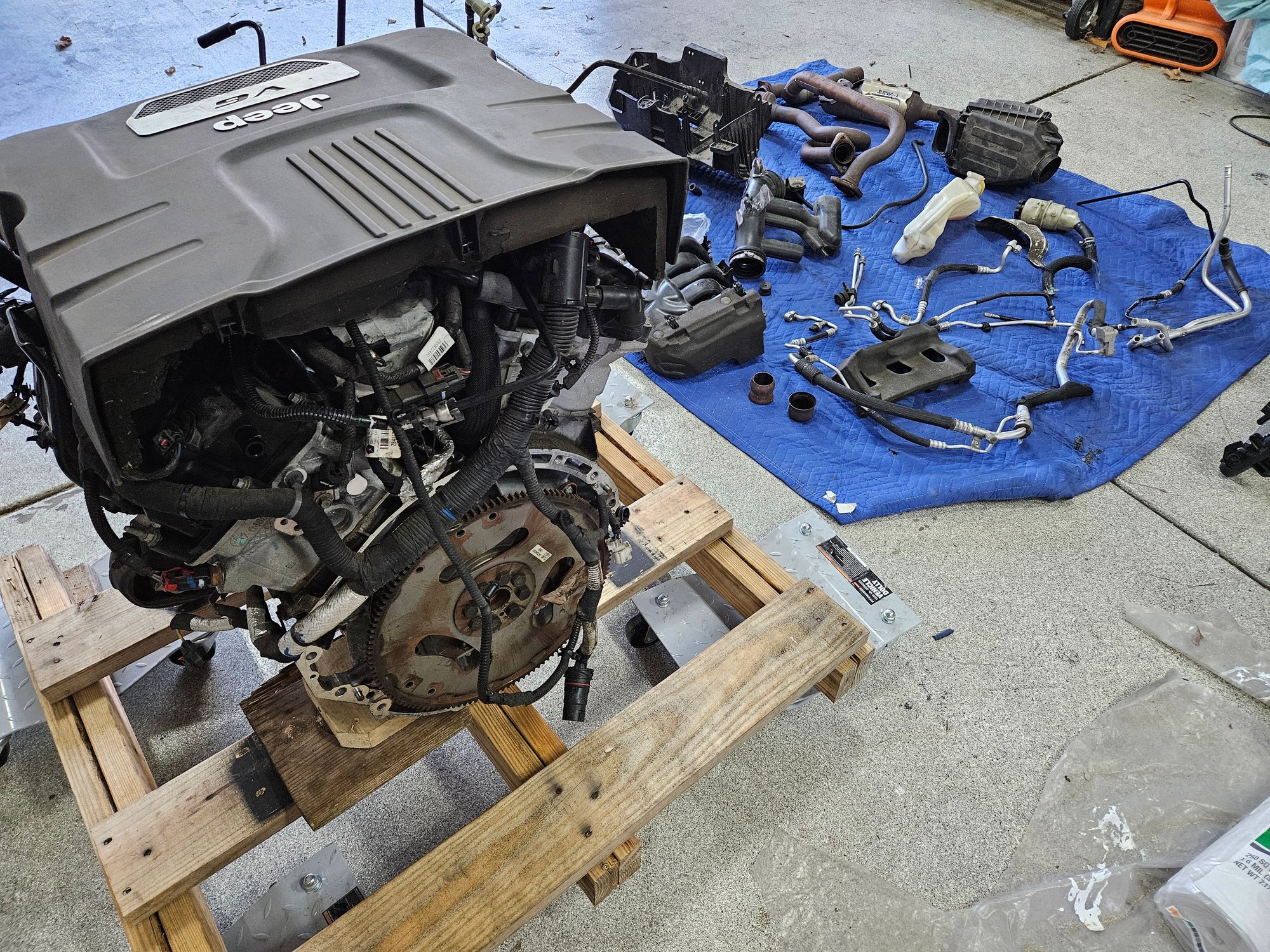

PS. If you're in the market for a very well-maintained 3.6L Pentastar with 80k miles on it, I have one boxed up with OEM accessories:
