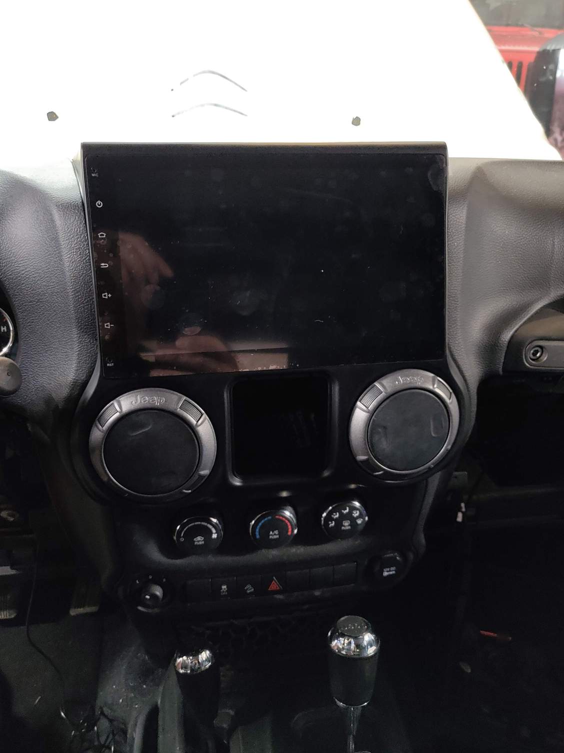

While I was there messing with the dash, it was a good time to pull the factory stereo. I replaced it with a 10.5" touch screen from Seicane. Like most Chinese made electronics, there were no installation instructions, but it was relatively simple overall. The final fit of the dash is not perfect, but it's fairly close. This stereo has plug-ins to run multiple cameras, among other external options. I purchased a rear view camera, but thinking about buying another so I can mount one under the front end for trail riding, as the hood makes it very hard to see over the passenger side.
