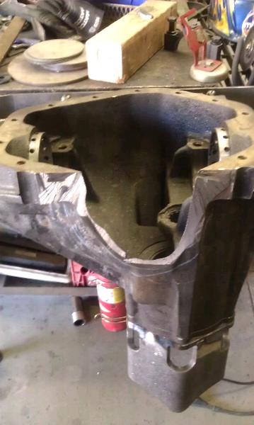

Thumbs up Shaving the 14-Bolt
I made it over to the Higher Ground shop today in time to see Jim and his crew starting the shave on my 14-Bolt. This is definitely a lot more complicated than I would have thought - not hard for them - but there is no way that I could have done something like this. A LOT of measuring and preparation - once you start cutting there is no going back.
Drawing lines for the cuts:
Red line shows the final cut; white line shows how much ground clearance we are gaining:

Thumbs up Shaving the 14-Bolt (continued)
Starting the rough cut:
Rough cut finished:
Test fitting the bottom plate:
And test fitting with the new diff cover and bottom plate together:
Old Jun 7, 2012 | 07:32 PM
  #590
CALIJK's Avatar
Posts: 2,942
From: Valencia, CA
Jim figuring out where he needs to trim down the rough cut:
Grinding down:
All done:
Jim says the bottom plate gets welded on tomorrow, and then they will start the shave on the front 60. I also took some video today, and if I have time, I will post it up.
