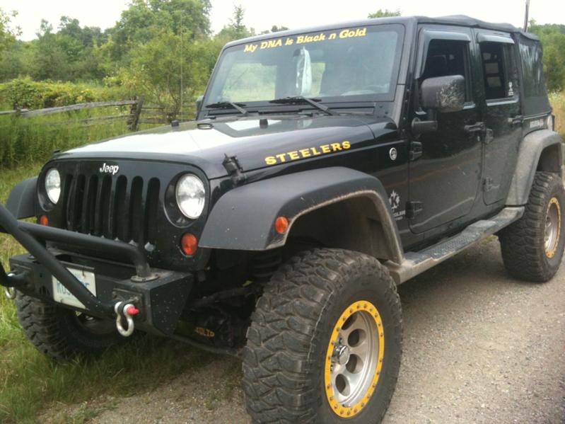

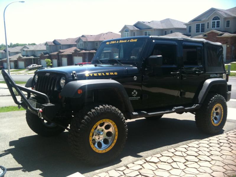

Hi everyone finally have my Jeep ready to do some offroading.... Teraflex 3" lift, Mickey Thompson 35" MTZ's on the MT classic rims with beadlocks.
Question what are you all airing down too on the different playing fields??? What PSI for.....
Mud?
Sand?
Shallow water?
Deeper water 3 feet?
And do you air down on trails maybe with some uneven paths, gravel, small slopes and hills(dirt or grass)??
Thanks in advance for any input....

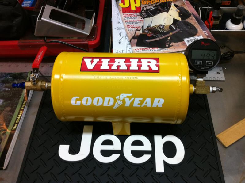

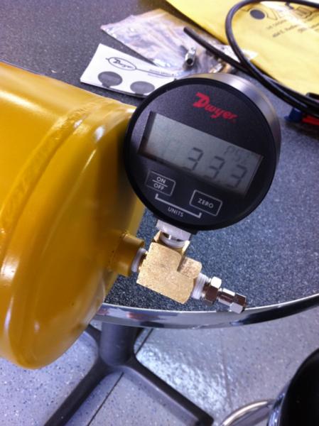

I use stauns, and I built this to calibrate them:
