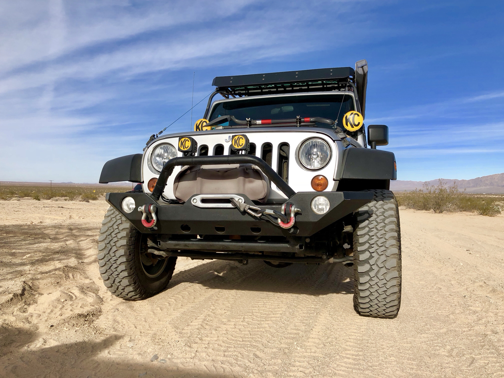

I've got to say I enjoy my manual on and off road so much more than an automatic. So. Much. More. But go with your gut. I'm trying to teach my wife to drive it but so far not much luck. I'll keep at it. It does limit others driving it......which is secretly a good thing! Haha. I trust about no one else driving my Jeep!Click image for larger version
