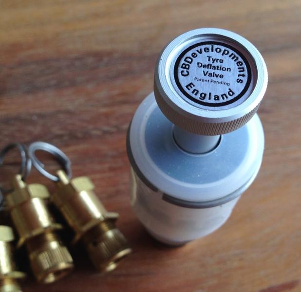

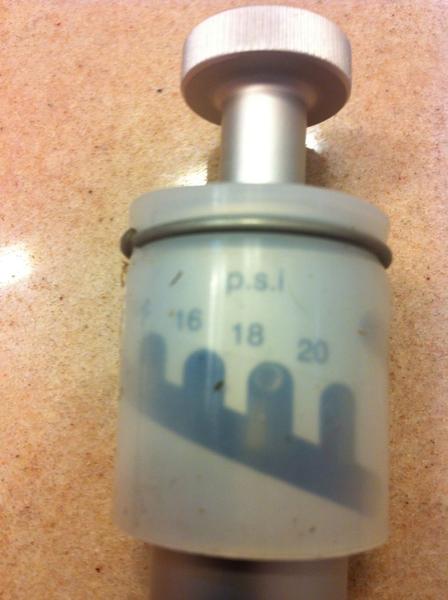

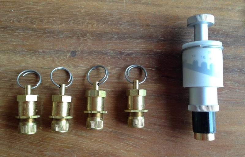

Old Feb 16, 2015 | 06:10 AM
GJeep's Avatar
Posts: 2,145
From: Israel
Originally Posted by dmwil
How easy is it to adjust them to a specific pressure and keep them there?
It's easy to adjust them, a little bit of patience is all it takes.
None of the Staun-type deflators, including the Staun itself, can be counted on to keep the adjustment, but there's a simple cure -- a drop of Locktite on the threading.
Another interesting option, expensive, but with multiple pressure options - you just push and rotate to set a desired psi.
This one has the range of 10, 12, 14, 16, 18 or 20 psi :
Name:	Tires - Air Deflators 233 - resized.jpg
ID:	597012 Click image for larger version
Name:	Air Deflators 002.jpg
ID:	597013 Click image for larger version
Name:	Tires - Air Deflators 234 - resized.jpg
