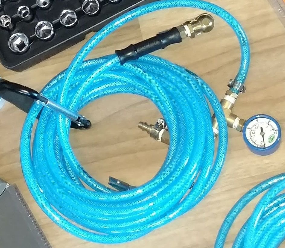

Originally Posted by RedRubycon
I use this goofy home-brew contraption. Equalizes pressure between tires while it's at it. Bit convoluted, ended up not being the cheapest since I had some trouble finding some parts I wanted, but works like a dream! Airs down 2 tires at a time to exactly the same pressure, quick and easy as can be.
One day I'm gonna make me a fancy tire deflated like yours...until then, I just pull the valve core.
It took me easily 20x as long to find all the bits and pieces as it did to put it together. Assembly is a snap, but finding everything can be a little tricky.
Admittedly, I was originally looking for a cross connector and wasted a ton of time trying to find one. It would be better than using a pair of T's, but I looked high and low to no avail. They're available online, but I was impatient and wanted one right away.
Just tried it out with the new hoses I installed the other day (the ones in the picture), and while I have WAY too much length on it, it works AMAZINGLY well. Can air down a pair of tires in around a minute or so (depending on how low you go) and makes airing up really easy too, since I can hook my compressor straight into it and air up 2 at a time as well. Even though I ended up spending way too much on the whole setup (probably put $50-60 into it total, I lost track with all the different pieces and replacement hoses and whatnot, since I made a poor choice on my first attempt) I'm extremely pleased with the end result.
