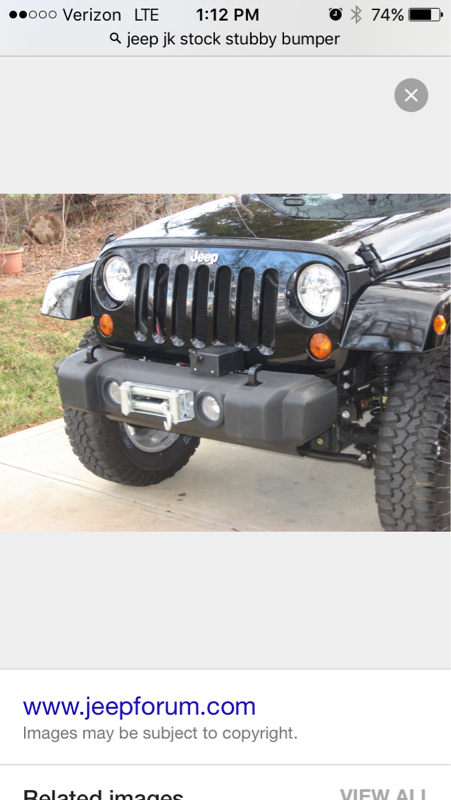

durffjk's Avatar
Joined: Jul 2014
Posts: 166
I saw one a wile back where they cut along the top and bottom seam and folded it back. Then plastic welded it on the top and bottom. Looked clean. Here is a pix of one I found on a Google search. Click image for larger version

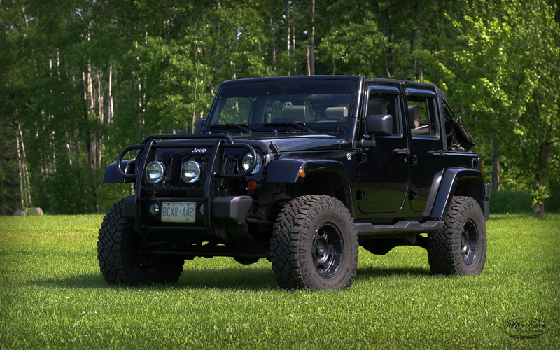

jtphoto JK's Avatar
Joined: Apr 2008
Posts: 1,267
From: Thunder Bay, Ontario
Way back when I still had the stock bumper. I cut it back to the bumps and also had an ARIES grille guard on it.

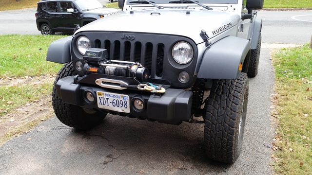

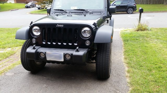

jdavis2nd's Avatar
Joined: Jul 2015
Posts: 18
From: Sterling, Va
Mine:

Buddy's:
Epoxy, Bondo, and truck bed liner
