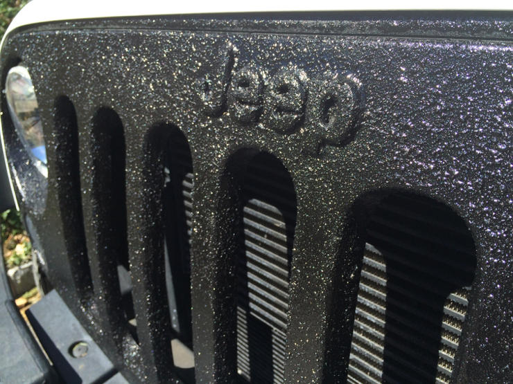

So I've been bed lining a few things on my Jeep recently with rust-oleum bed liner, it comes out alright with some texture but I'm looking for some thing with A LOT of texture... Ideas? I'm sure you guys have a lot of experience with this thanks in advance
Rust-oleum on the grill

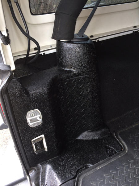

Hey man. Use the rust oleum role on liner. It holds a lot better and looks great!

That looks so much better... I was just looking into Herculiner, which looks pretty good too... You think I could bed line right over the original bedline? Or re sand it?

You can keep adding coats to the role on till it gets as textured as you want it. First coat will look like the spray but 5 or so will be way better

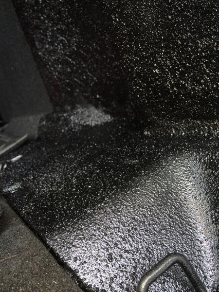

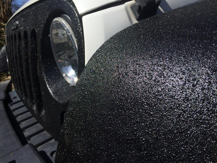

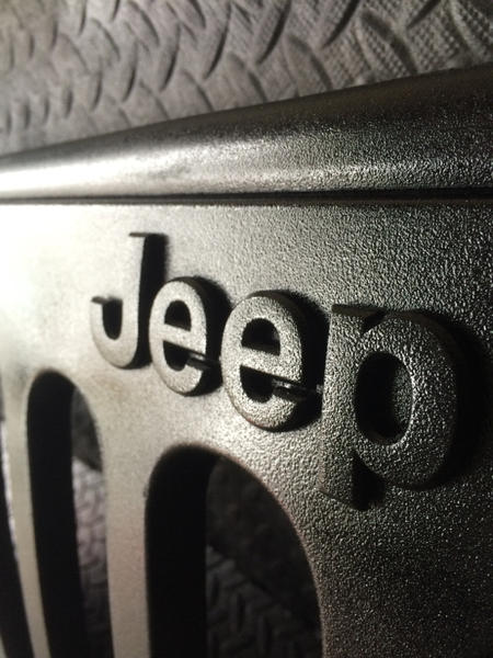

Btw forgot to show you the results, Herculiner roll on

Looks great, does it seem easy to clean? At first the rustoleum spray on cleans well but now it's really starting to stain from mud unless I scrub the hell out of it.
