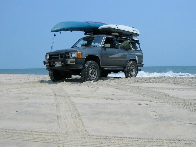

Well done and I hope this comes to fruition...I NEED this to come to market! Thanks for the time you spent developing this. I would love to have the roll up sides with the hard top. The safari thing with the Canback top on the 4Runner was awesome and my little girl loved it...got the open air without the sun beating on you during those long road trips. If it started to rain, we were good to go in 3 or 4 minutes.
Your concept really makes me miss my old 4Runner with the Canback top and rack with the roll up side panels...

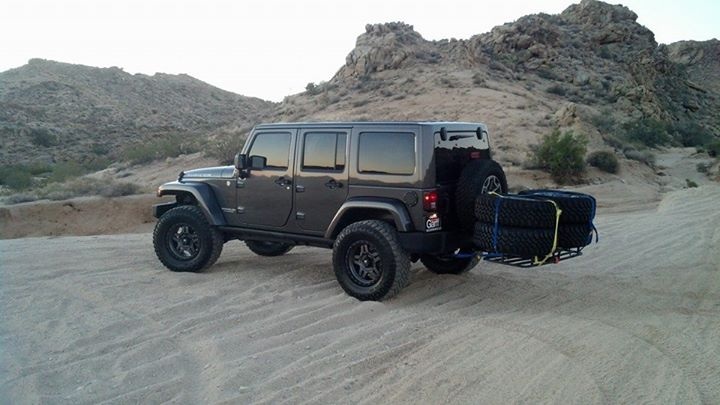

Which I just replaced with this...
