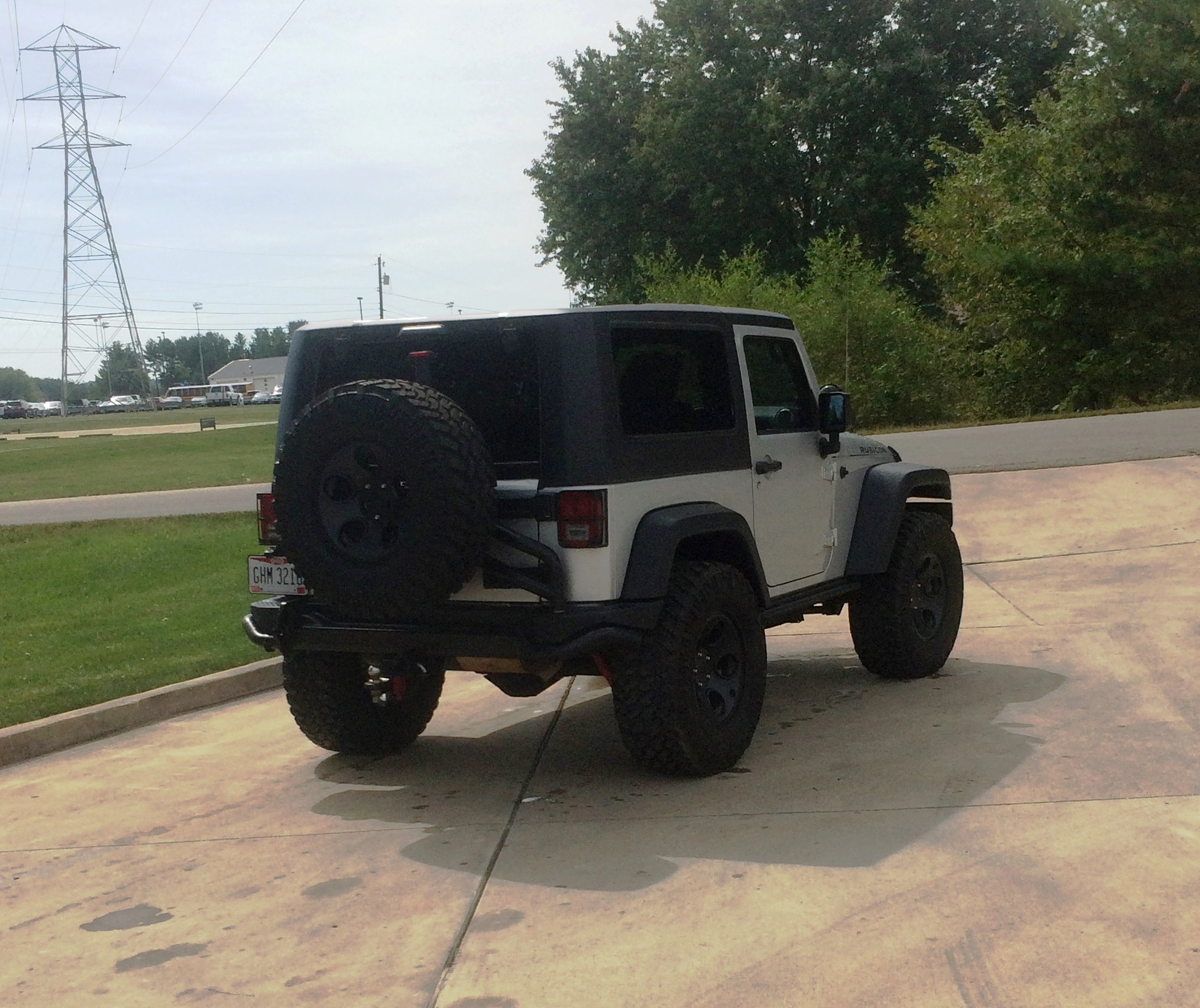

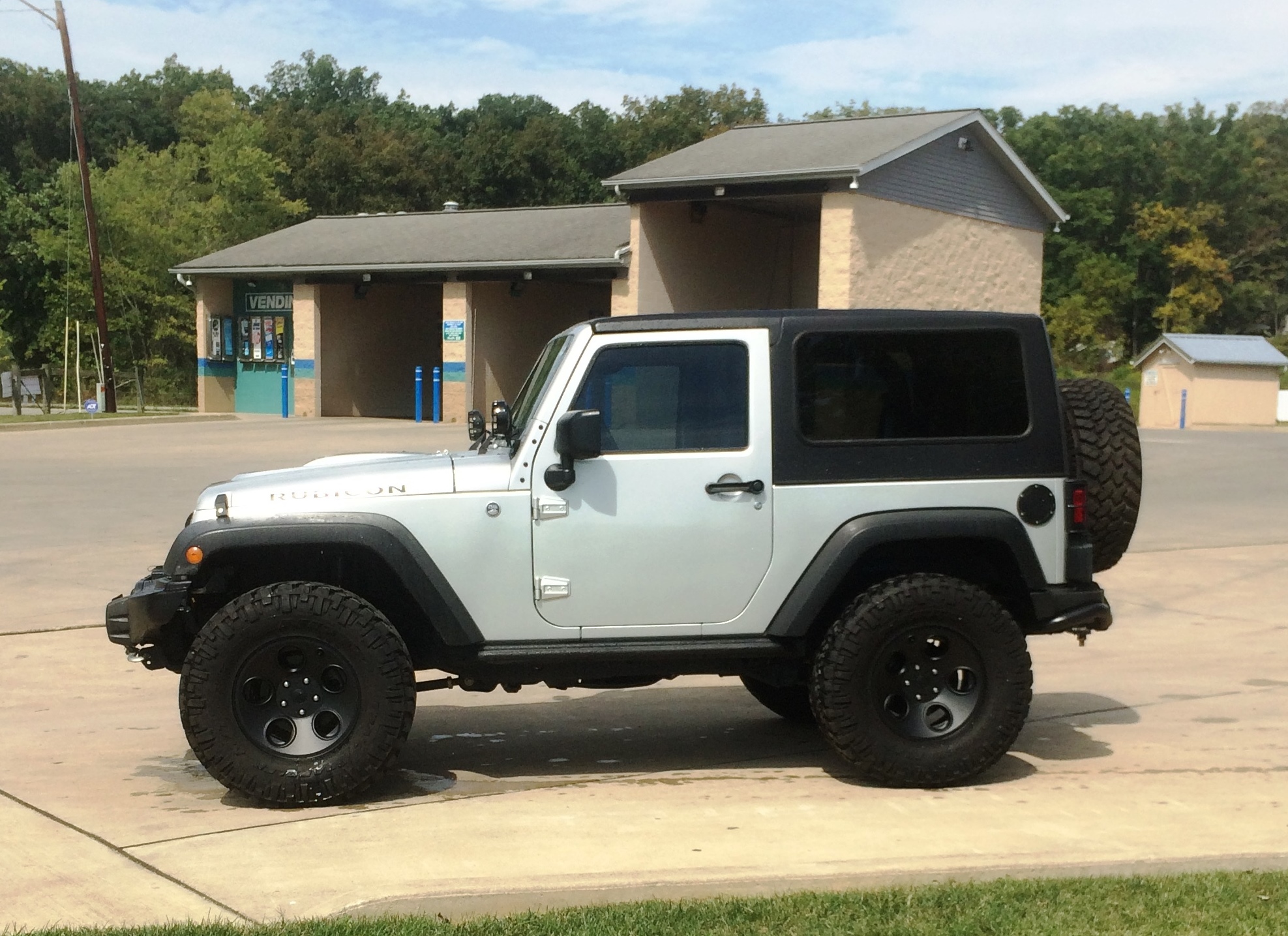

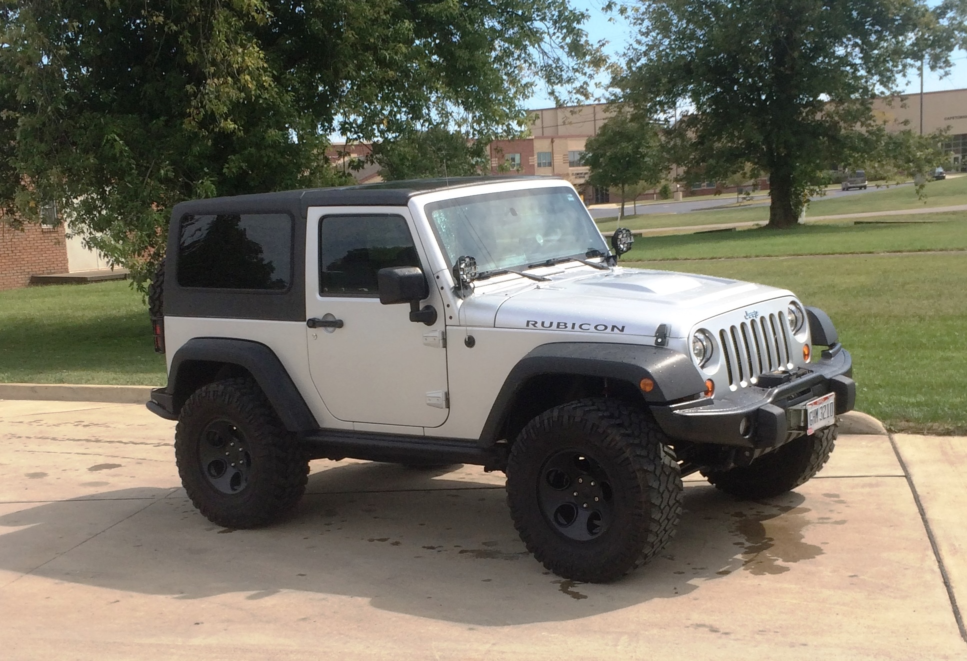

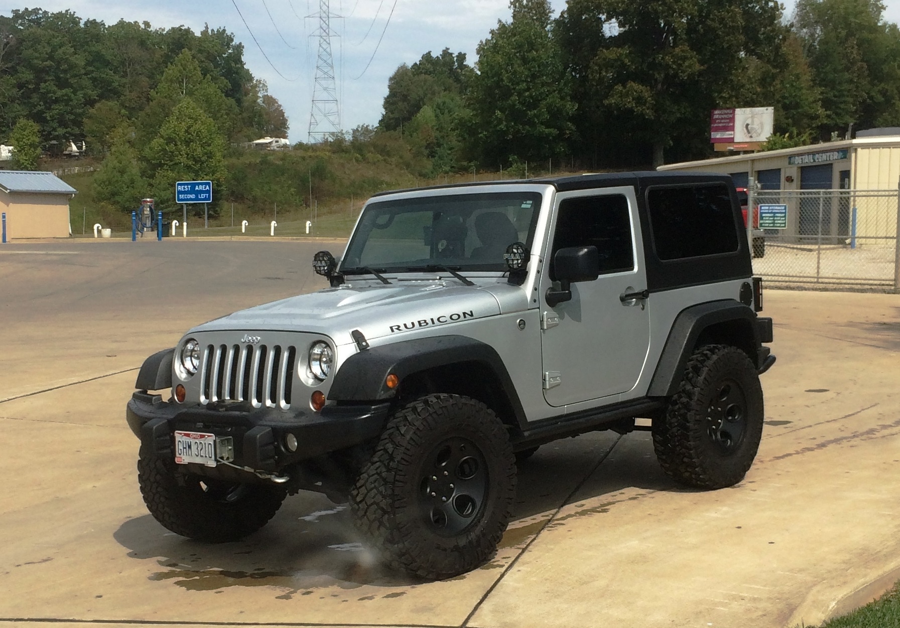

I don't have plans to build a 2-door version, mostly because I don't have a 2dr JK here to work with. I've done the design work and drawn concept drawings to show what it would look like if it were built, but no reason for me to actually build one without a Jeep to put it on .
I will bring my 2 door over to your garage for you to work your magic on. I would like the top in black please, with Alpine windows and a roof rack...
