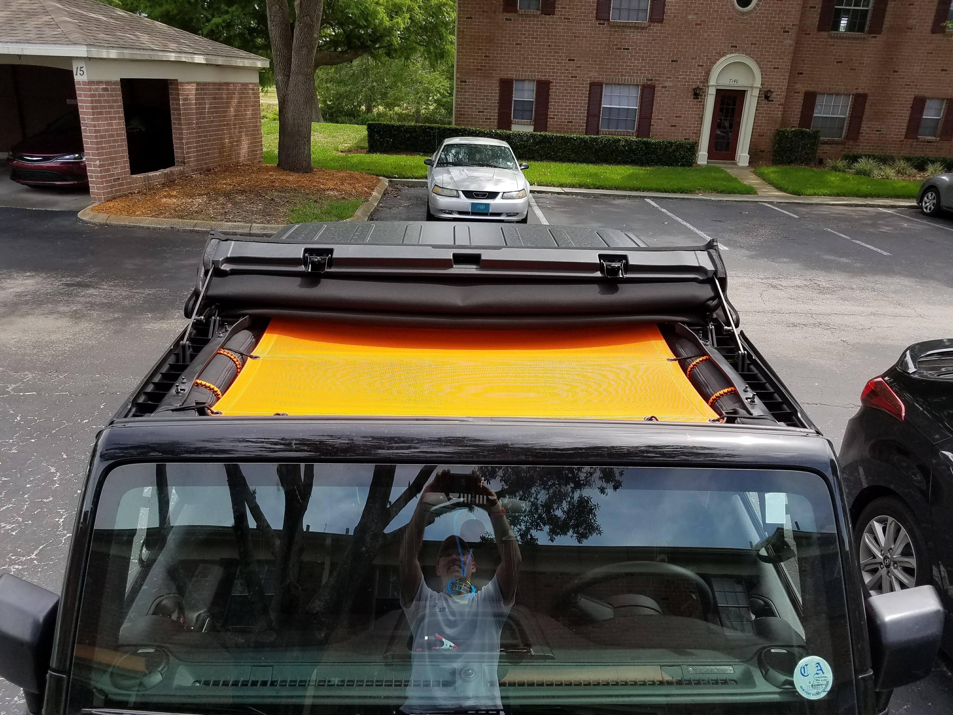

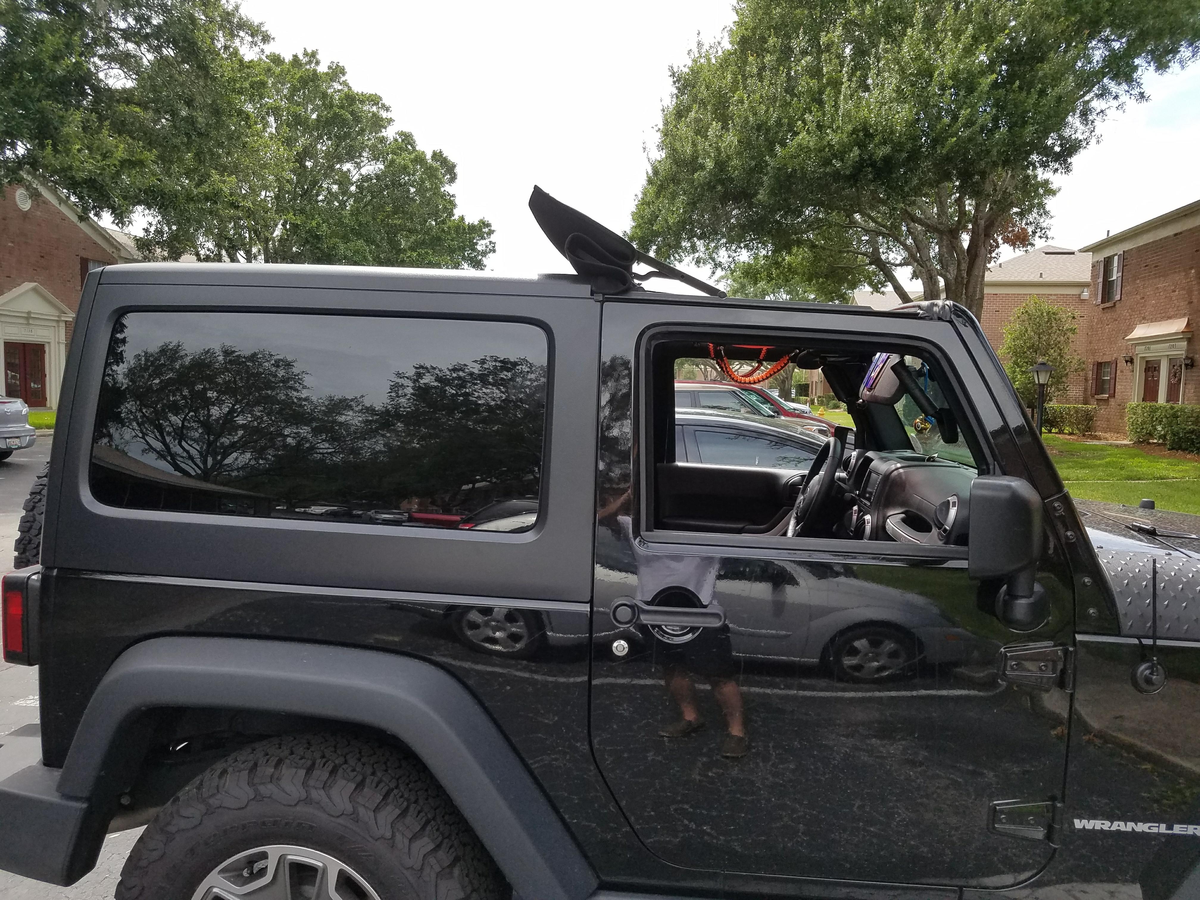

Man, you just keep making things better and better! Question, I've always heard that the tops/roofs on convertibles adds to the rigidity of the body..kinda like structure support I suppose. Does this apply to the Jeep since it has a full frame or is that mainly an issue with unibody vehicles? I'm absolutely loving your creations/ideas. I'm chomping at the bit now waiting for the rear sliders to come on sale. This too would be a must have! This, the rear sliders and the Webasto Throwback(added pics) I just installed would totally complete my JK and provide everything I'm looking for with my hardtop! Please tell me you have a DIY kit coming out for this?!
Thanks .
Hardtops add no rigidity to the Jeep, in fact they're intended to flex with the Jeep.
I don't have any plans at this point to turn these skylights into a DIY kit, this is just something I wanted to try since I've got these extra modular hardtop parts lying around begging me to do something interesting with them .
The 2dr slider window kit is in the hands of the hardware company and the RV window company now; I heard from the hardware company that they're scheduled to ship preproduction retrofit kits to me and the RV window company on June 16, so that's moving right along.
