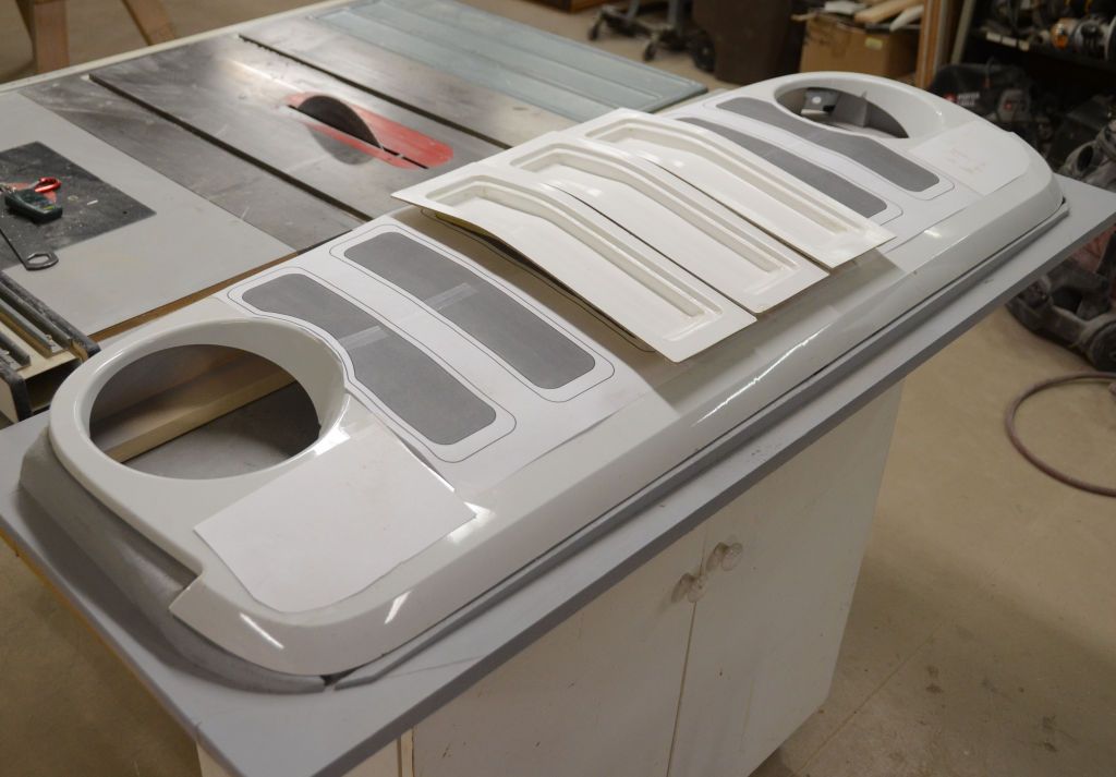

Back to the JL Grille for the JK project, I've got five slots molded, two more to go. Once I mold the final two I'll assemble a complete grille to make the full grille mold from.
All of the JL grilles I've seen have inserts and mesh in the slots. I'm heading in the same direction with this grille - I've molded the slots with inserts, mesh will be installed after the complete grille is molded. In this photo I've colored some inserts light gray (can't really do silver with my drawing program so my coloring job doesn't really do it justice).
The photo below is of the grille on FCA's Safari Concept Jeep, it's got the inserts and mesh and this is where I'm heading with this project.
