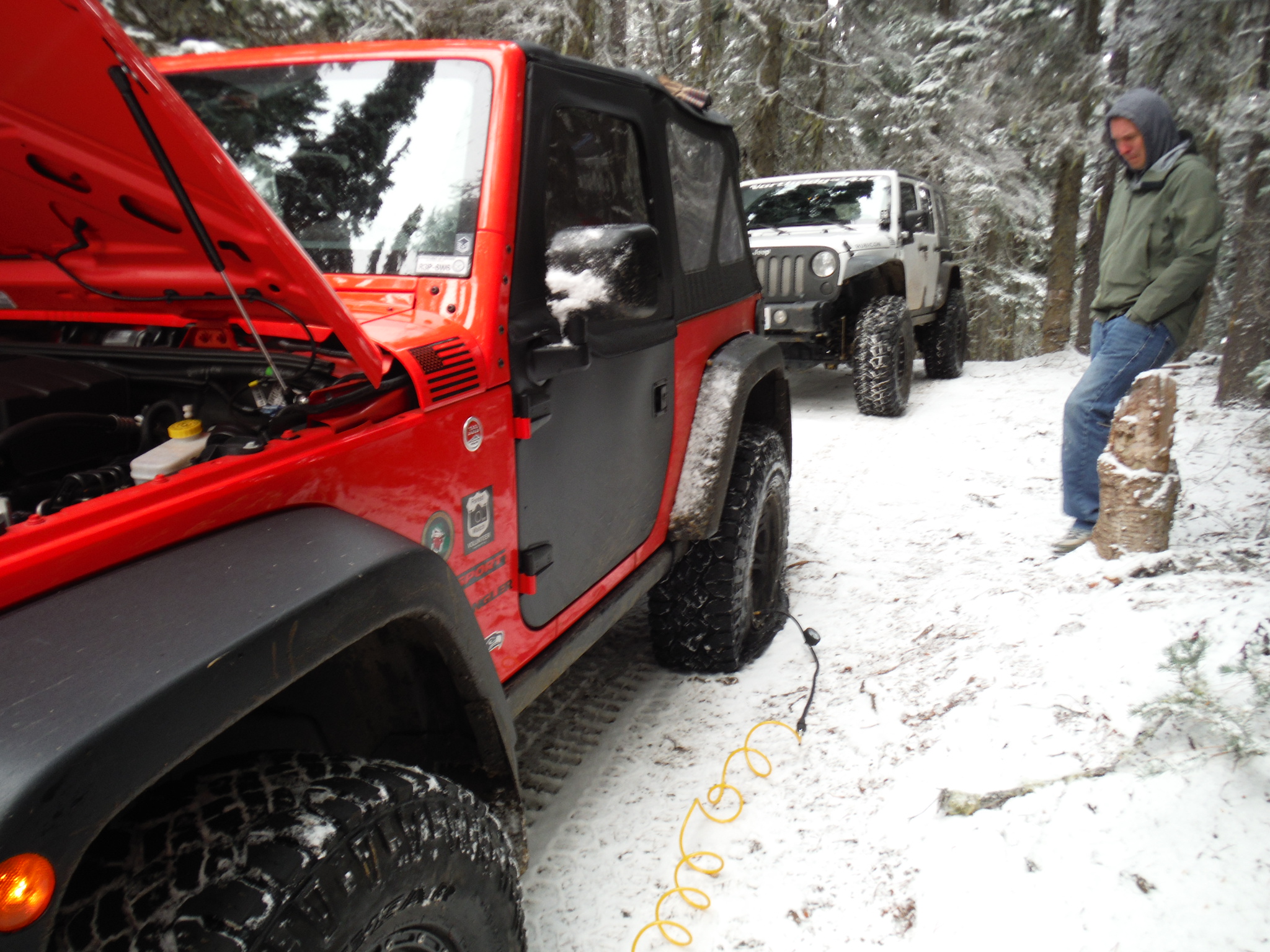

You guys jinxed me. Bought a new tire tonight. No tire would've survived what I hit and the way I hit it. 3rd gear, low range, lockers engaged, and I wasn't stopping for anything. At least the new one only cost me $47.

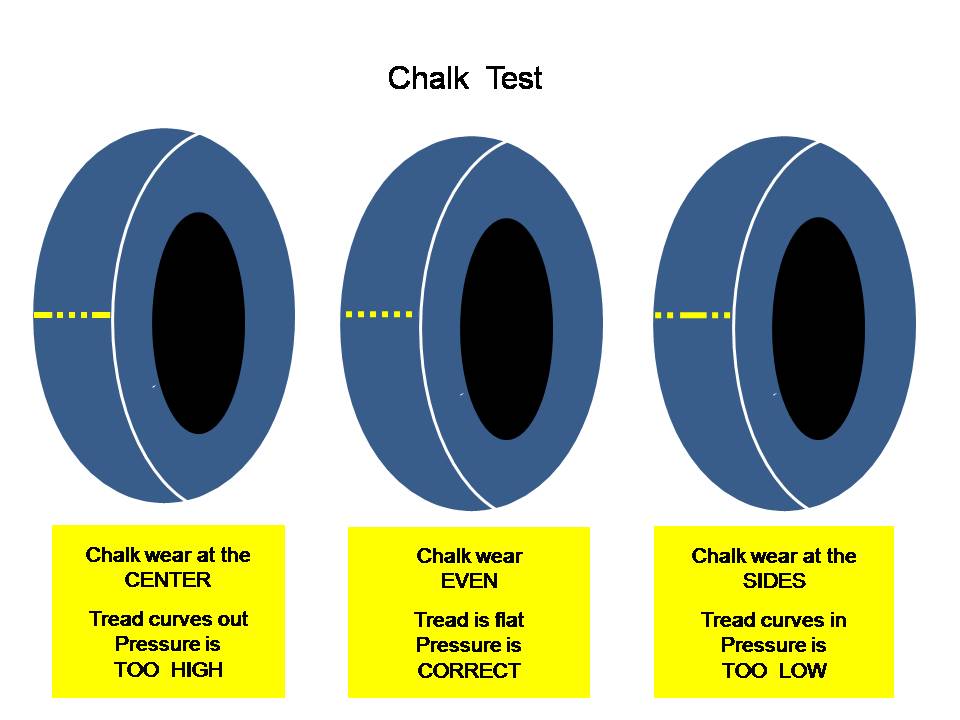

depends on the tire the Goodyear kevlars with the stiff sidewalls demand that kind of pressure.
For those who are unfamiliar with it, I'd like to mention the chalk test for determining the right pressure for DD.
Too low or too high pressure causes uneven tire wear and reduces tire life span.
Inflating to the correct pressure also improves tread grip on roads.
Test both front and rear wheels.
I'd start with 30 psi, on horizontal, hard, dry, flat and smooth surface.
If the chalk wear is not even, test again with 2 psi increase or decrease, according to the first result.

You weren't hanging with that CascadeWanderer fellow, were you? He's been known to do some crazy stuff now and again.
BTW: How do you score a new tire for $47? I have four new Duratracs to be installed tomorrow and they cost me a bit over a grand.

No, we get into predicaments all by ourselves.
Got the Lifetime tire insurance at Discount Tire which is really only good for so many years and a certain wear, but so worth it.
