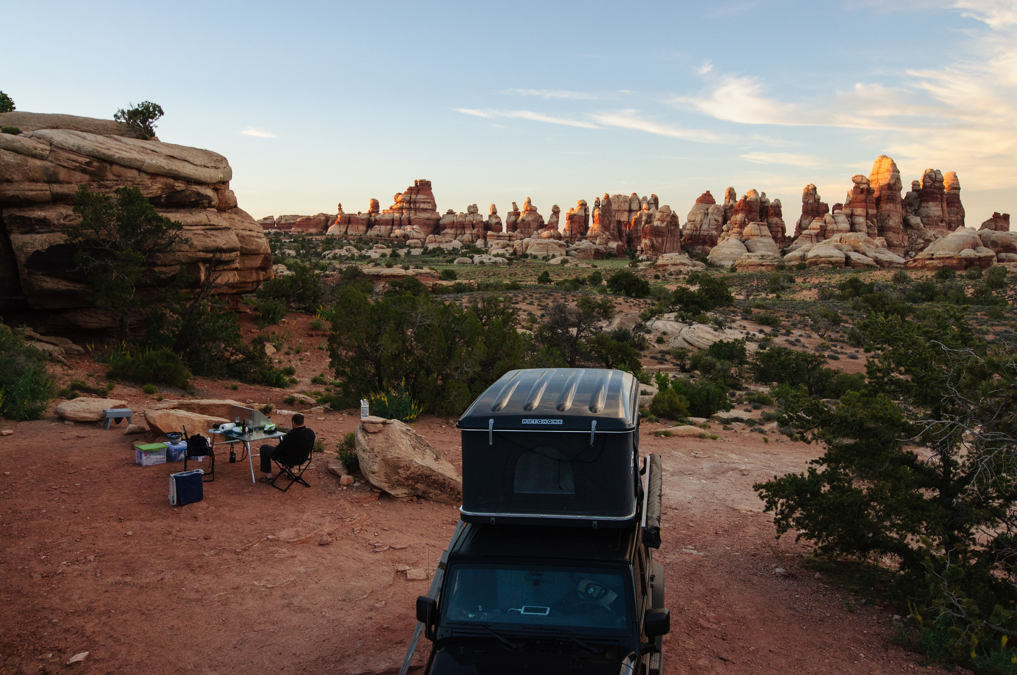

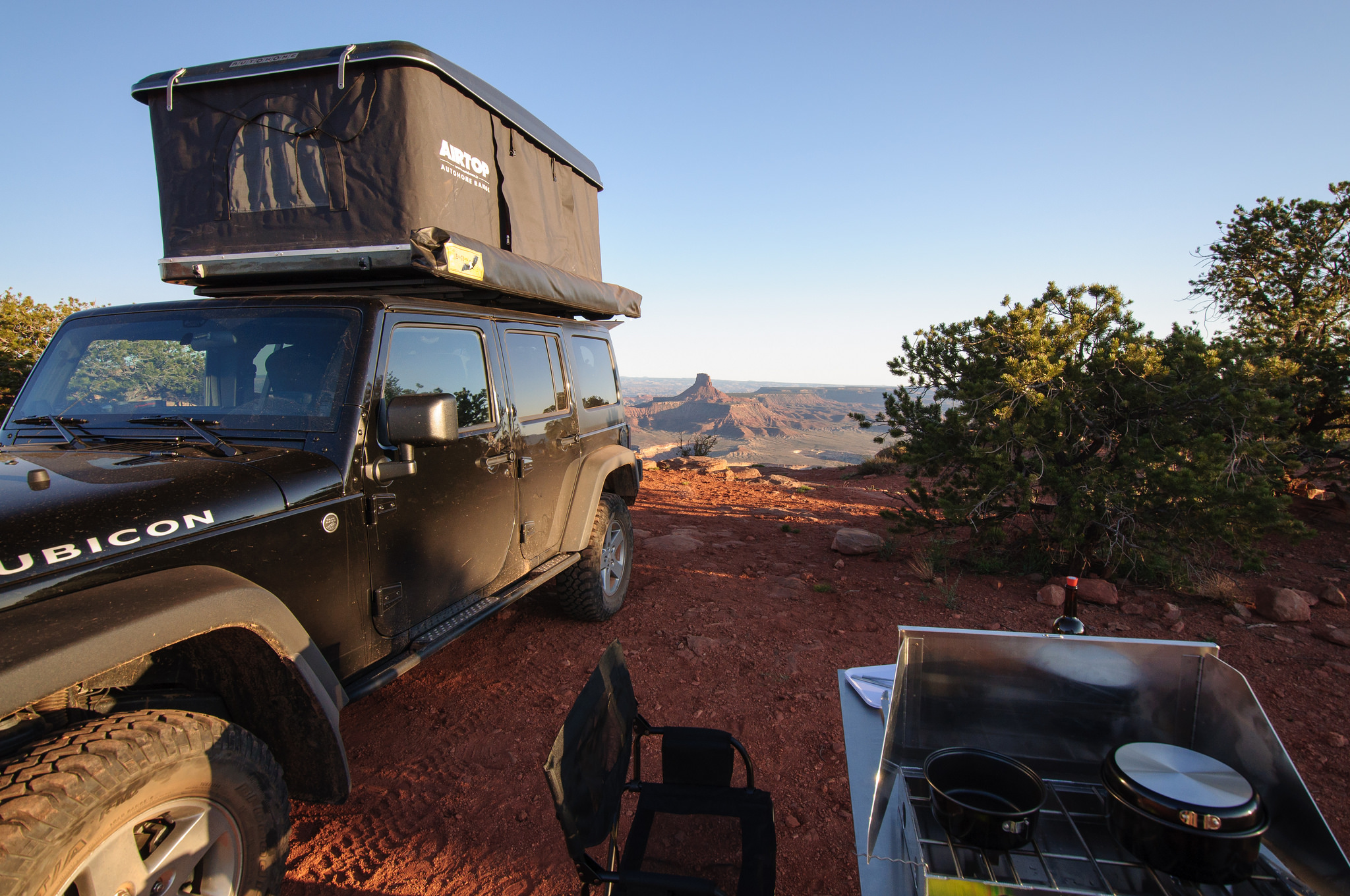

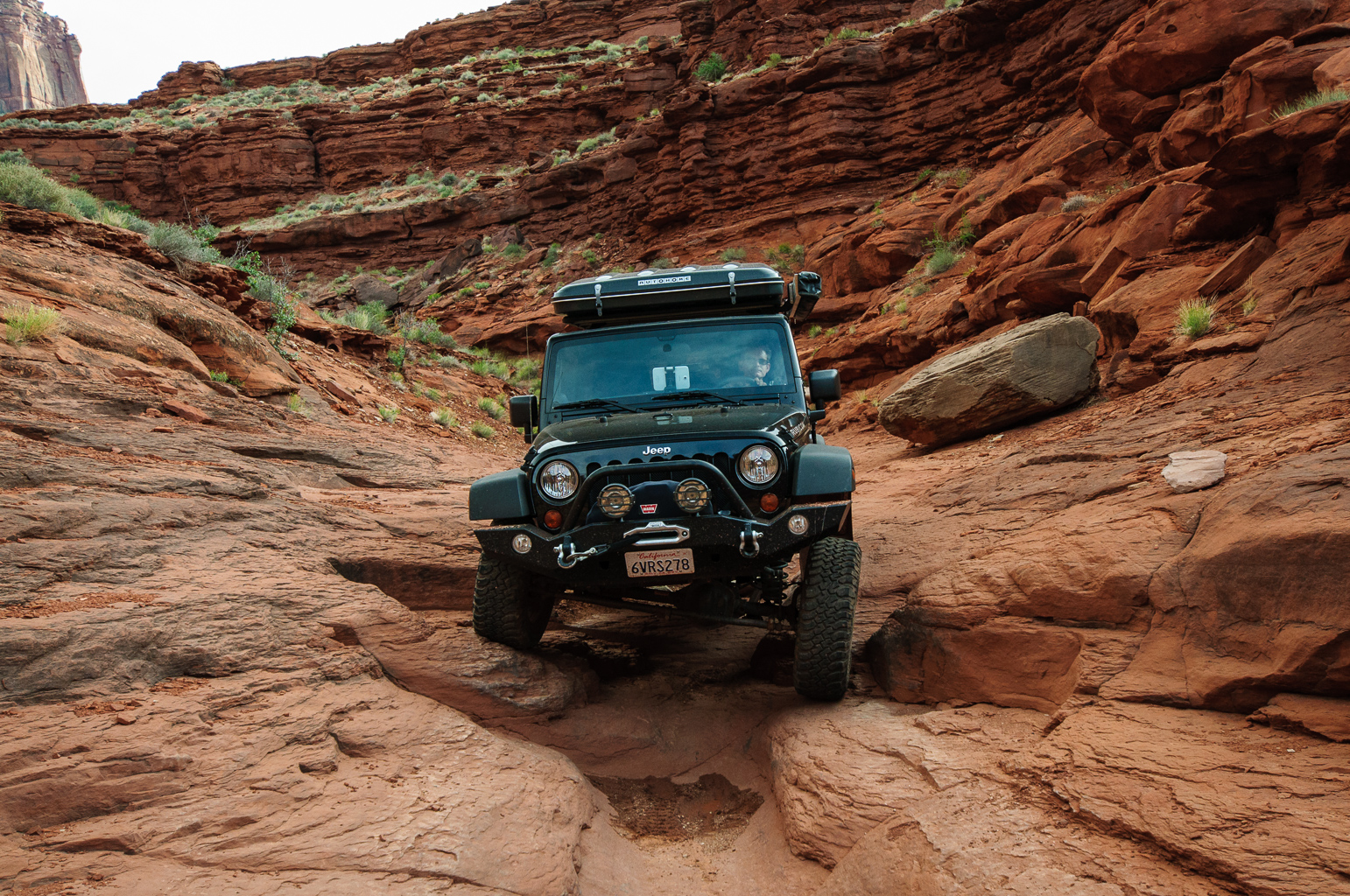

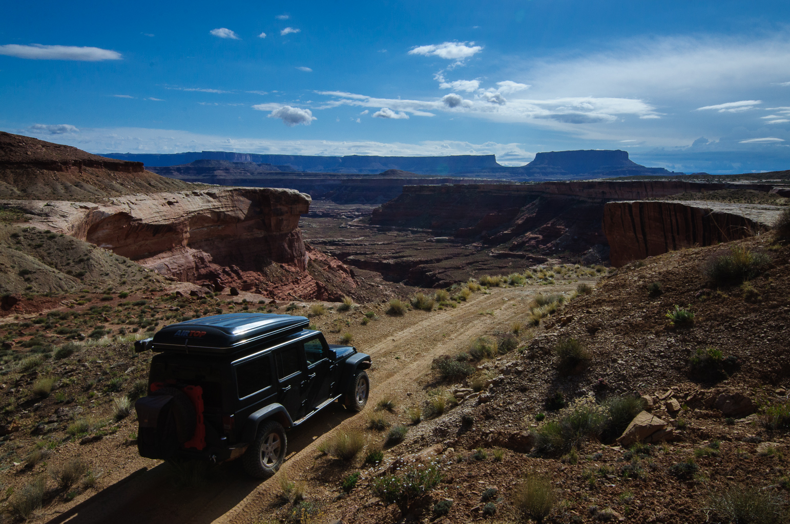

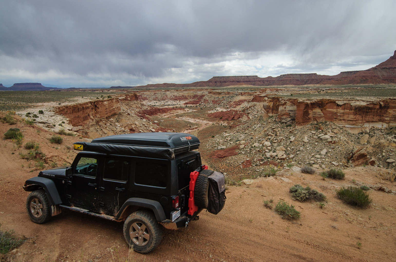

Here is some of my observations running a RTT and sometimes ground tent. (sorry not very organized, basically a brain dump)
• (Installation) A RTT is a pain in the a$$ to install and uninstall.. It’s heavy 120lbs. So if you plan on using a RTT, I highly recommend that you keep it on the Jeep full time. Unfortunately my garage door not have the height clearance, so I have to remove the Tent after each trip (or park outside). Now this means that I only use my RTT when I go on my 2-week trips to either Utah or Colorado. For shorter weekend trips, I use a ground tent for convenience of not having to install the RTT. Also whatever roof rack you chose for your RTT, it needs to tie into the jeep body (roll-bars, tub etc.) and not just the rain gutters of the hardtop.
• (Access) Getting in and out of a ground tent is MUCH easier than going up/down a narrow aluminum ladder. So the misconception that a RTT is easier on an older person is not correct (IMO).
• (Comfort) I love the 3” foam mattress in the RTT for comfort, but it’s does not have super high R-value.. So unless you are camping +45F, you will still need a sleeping bag. I have a comforter in the RTT for summer months, but use a sleeping bag for fall/winter/early spring time. I think one of the reasons for the cold getting thru the RTT mattress, is because cold air can circulate under the RTT. A good foam/air mattress on the ground will actually be warmer. One thing I like about the RTT is that during high wind in the desert you do not get any sand inside the tent, where the 2-3 season ground tents with netting on the inner tent will allow fine sand to blow into the tent (even with the rainfly on).
• (Visibility) In a RTT you have a much better vantage point to see the landscape and canyons below the horizon, but hard to see the stars at night. Some ground tent allows you to leave the rainfly off and you can lay in the tent looking at the stars (weather permitting).
• (Setup) The hard shell RTT I have has gas shocks and will literally setup in 2 minutes and that is including setting the ladder op. It’s pretty easy to get the Jeep level by driving up on a strategically placed rock or two. A soft RTT might take a little more time to setup, but still faster than a ground tent. With a RTT you do not need a flat piece of ground without too many rocks as you would with a ground tent. But one advantage for a ground tent is that you have a lot more flexibility of where you can place it. A RTT location is limited by where the Jeep is parked. A hard shell RTT is much quieter inside than a regular ground tent, especially in the rain. A hard shell RTT can be folded down wet and will dry out while driving as air can circulate a little in under the hard shell.
• (Takedown) The hard shell can be taken down in 5 minutes with 2 people and maybe 10mins with 1 person. Even after raining all night, the tent material is not wet due to the hard shell shedding most of the water off before it even hits the tent side fabric. One thing to keep in mind is that with our Jeeps, the tent it up fairly high in the air and I have to stand on the rock rails or rear bumper in order to tug in the tent fabric when taking down the tent. (I am 6’ tall).
• (Investment) A RTT can run anywhere between $1200 - $3600+. That is a lot of dough and that is not including the roof rack.. Even a very nice 2-3 person ground tent is “Only” a ~$400+ investment.
• (Drivability) A RTT has some wind noise over 60MPH and does not like to go over 75-80MPH. One time I drove home on the I-15 thru the Mojave Desert and there was high winds, I had to slow down to >60MPH together with all the RVs etc., any higher speed the hard shell would separate on the sides and the tent material would get pulled outside!. If you are already running 35” tires and roof rack, this might not matter to you as you are used to the noise and maybe driving a little slower. Even with the newer more powerful 3.6L motor the Jeep (Auto) is downshifting a lot more than when I have the RTT off the Jeep. I think my MPG went down ~1MPG with the RTT/Roof Rack on the Jeep. On dirt roads I don’t really feel the RTT at all.. But once you get into really rocky terrain, you get a little more oscillating (side-to-side). You can also feel the RTT a tiny bit in off-camber situations, but not as bad as you would think. I have done Hells Revenge, Fins’n’Things and Lockhart Canyon trails without any issue at all. One thing you do have to keep an eye on is tree branches as they will hit and drag on the RTT. I drive mostly in the desert so this is not a big problem, but I would imagine Pacific North West you would be scratching up the hard shell or ripping the vinyl cover on the soft shell RTTs?

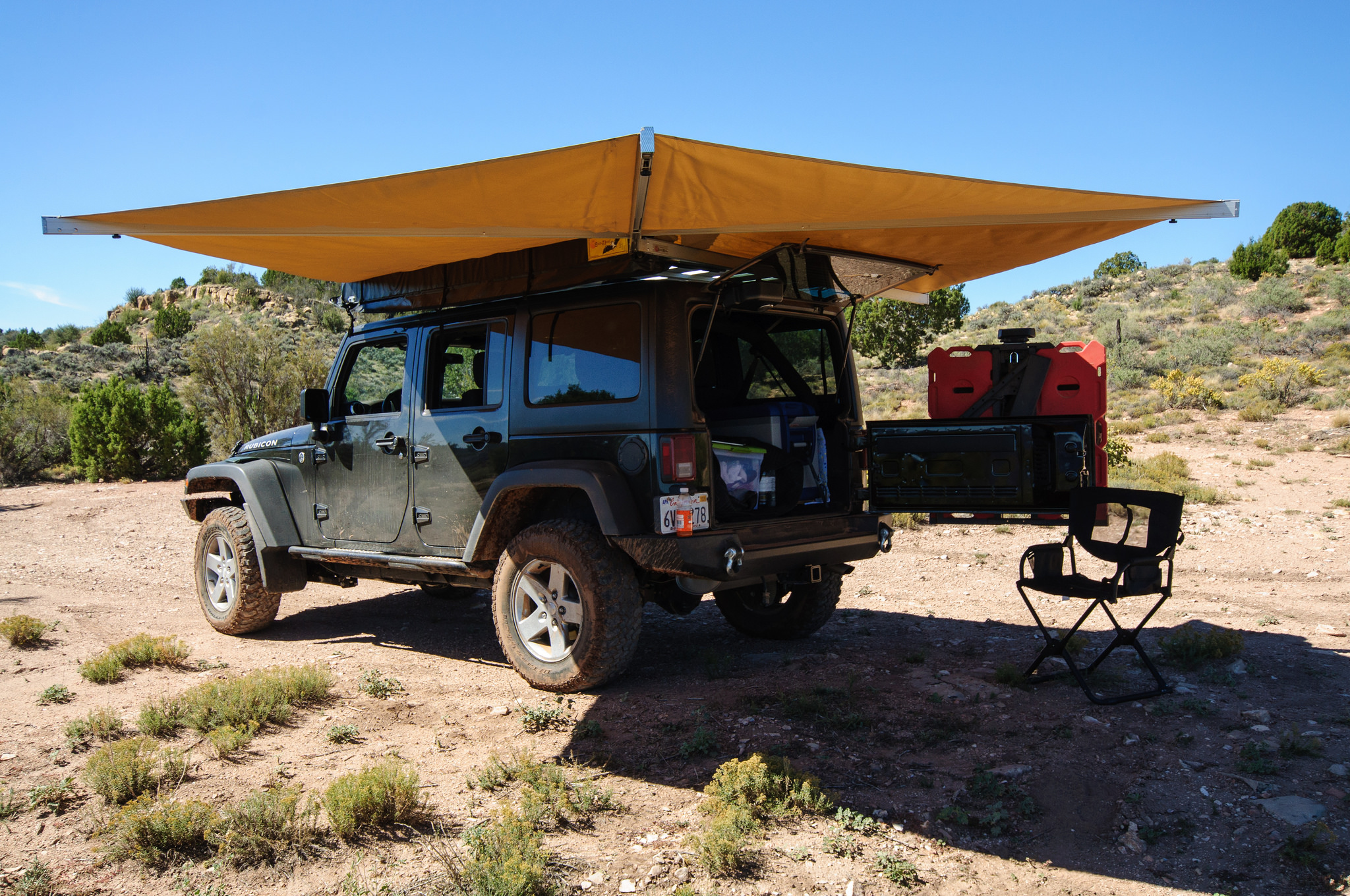

BTW. I have a 270 degree awning also (see pictures) and I LOVE it.. Awesome for shade during lunch breaks in the hot desert and for those times it rains (low wind). On one occasion we were camped by the Green River in Canyonlands NP (Millard Canyon CS) and it was raining lightly with very minimal wind. The awning allowed us to cook dinner and even sit up into the evening watching the scenery, instead of going early to bed in the tent.
