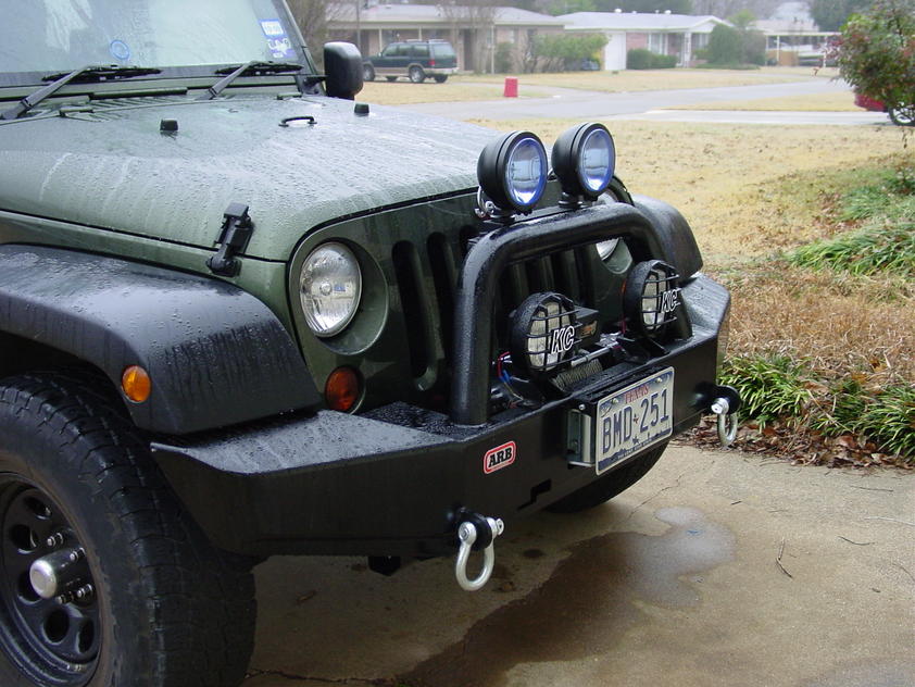

It does have tabs. I didn't grind them off. I'll be putting them to good use shortly. You can control the amount of crinkle in the line-x. It is a rubber additive. The more you add, the more granular it looks. The photos make it look more granular than it really is. I hope the installed photos will do it justice.

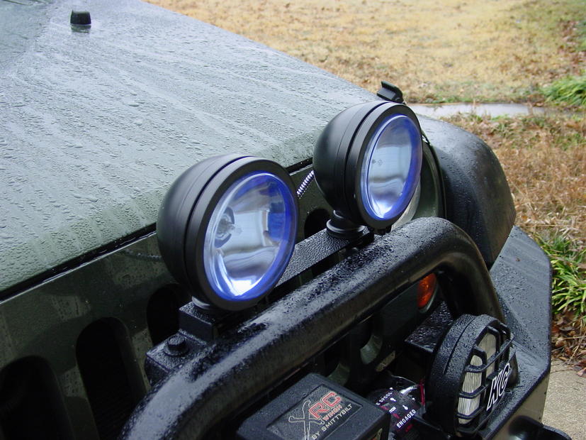

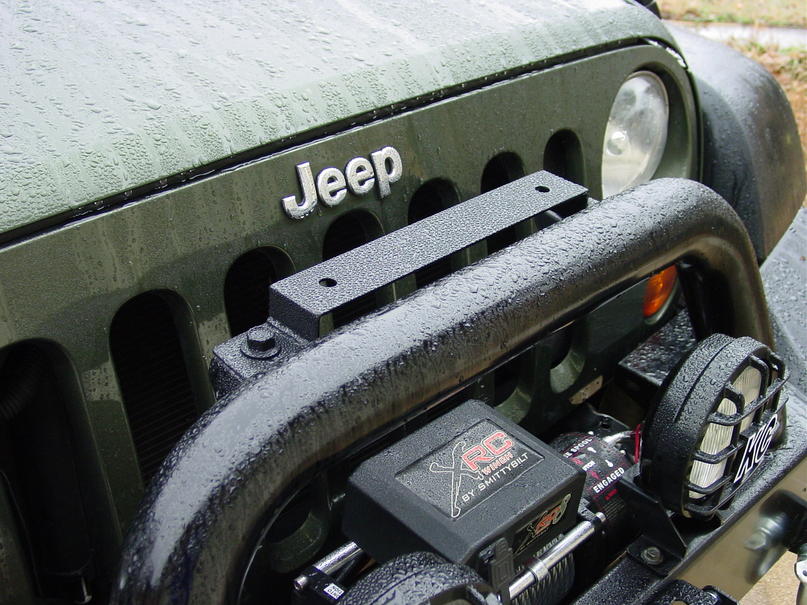

i just got the other ARB bumper, that doesn't have the turn signal and fog light holes, and i am curious to see how you use the tabs on the back side of the bar. the tabs are too far down on the back side, so every light that i had would hit the bar. the only way i could put lights on it was to make a bracket connecting the tabs, but raising it in the center.
