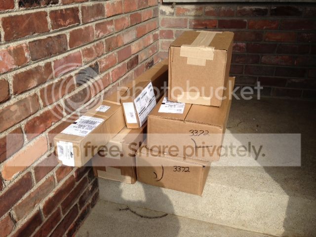

Default Let there be LIFT!!!
I just returned from a business trip to Frankfurt, Germany where I attended the Frankfurt Motor Show. Yes, I got to oogle at the diesal Polar Edition JKU...too bad it isn't coming here anytime soon. But, when I got home I found presents sitting on the front porch as my 2.5" AEV lift kit had arrived! What's funny is that AEV is only a 30 minute drive from me but if I were to buy it direct I'd have to pay state sales tax. Therefore, I ended up ordering it from Northridge 4x4 since they offer free shipping!
Along with the 2.5" lift kit, I also found a set of AEV geomtery correction brackets from a member on here that lived local.
With that, I did a bit of reading on the install. I also did a bit of web combing as it seems the installation instructions are a little 'thin' in some areas. I found a couple of good resources and referred back to them often while installing.
