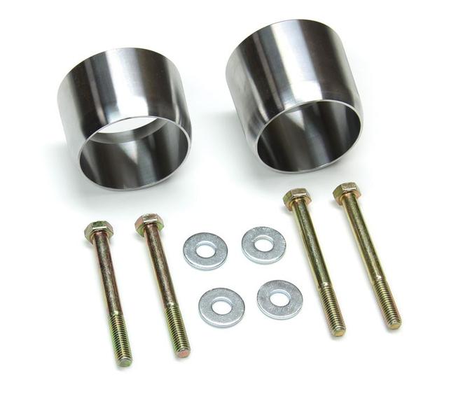

It's been in the 40's the last couple of days so laying on cold concrete hasn't been quite as bad. Anyway, I tossed in these Teraflex Exhaust Spacers to go along with the lift I did a couple months back. The pieces look real nice and seemed simple enough to install...too simple.
Below is Teraflex's video on the install:
http://www.youtube.com/watch?v=oKBlEpMaJC4&feature=player_embedded Seems straightforward. Remove/loosen 5 bolts and cut off a spot weld. Insert spacers, tighten 5 bolts. Celebrate with a beer.
Now for my real world summary!
Remove/loosen 5 bolts...check.
Whack at spot weld repeatedly with cold chisel and hammer...the spot weld laughs back at you...check.
Fire up the compressor and have at the spot weld with the cutoff wheel...the spot weld yields only to the point where you can get it flush with the clamp...check.
Switch to the 90 degree grinder with abrasive bit...spot weld is eradicated...check!
Insert the spacers and the 4 new bolts/washers supplied...check. Fight with the Y pipe to get it all aligned while tightening...check.
Tighten clamp at the crossover...check. Fire up the engine and listen for exhaust leaks...
I let it run for a few minutes and didn't hear any leaks per se. What I did notice though was condensation dripping from each spacer!
I crawled back under and double checked everything. alignment of the spacers seems pretty good on both sides. The bolts are tight even though getting at the drivers side bolt is a major challenge with a combo wrench. I then took to the internet and low and behold found this is somewhat common. I found the following thread on another site:
Long story short, seems like this is a fairly common issue and no one seems to have a good fix. Teraflex suggested torqueing to 25 ft-lbs so I crawled back under. Seems that I was already at 25 using my wrench so bolt torque wasn't an issue. I'm at a bit of a loss for now and will see if I can get a better alignment of the spacers but as I mentioned, they aren't bad IMO.
- Cost:
* Teraflex Exhaust Spacers - $45 and a bit of my sanity
