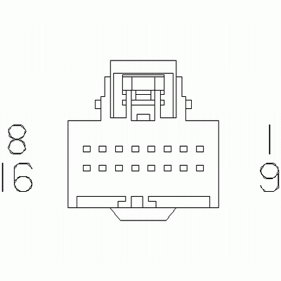

4. For clarification, here is the blue HVAC connector I referenced to. Notice pins 9, 10 and 16 are currently empty (bottom row).
5. While that's open for discussion, I drilled about a .750 hole in the dash for the sun sensor. It's tough to make a clean hole as the windshield keeps you from getting in there with a drill. I used a 90 degree pneumatic angle grinder with about a 1/4" drill bit in the collet. That made the initial hole. Not having anything larger that would still fit my grinder collet, I put a .685 countersink in there. It made a mess with chips flying all over but I ended up with a hole that the sensor fits snuggly into. Those are the next 2 photos:
6. That is about as far as I got. I did mount and plug into the new HVAC controller unit. It powered up fine and as mattro noted, the rear defrost button blinks with no other function for about 30 seconds. After that, it does begin to function more normally. Manual mode for heat/AC and fan level work fine. The rear defrost works fine too. Obviously, until I wire up the 2 sensors, Automatic mode doesn't work as intended.

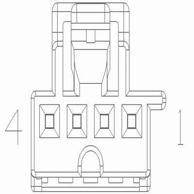

So, the 4 way connector I ordered for the Cabin Temperature Sensor has arrived. It did indeed include the terminal leads, splice connectors and shrink tubing.
Then, the last missing piece of the puzzle finally came together! Since the HVAC connector isn't available from MOPAR, I wasn't sure how I was going to get the terminal leads I needed to add to the connector. That is, until I was late night perusing eBay one evening and came across this beauty!!! The exact 16 way connector with about 4" of the harness intact. BUY IT NOW!!!!!!!!!!!!!!!!!
The plan is to simply remove the leads from this connector, solder them to the new harnesses I'm making and insert the leads into the HVAC connector.
So, with all the pieces now accounted for, I can start assembly!
On the sun sensor side, I got some 22/4 shielded wire and soldered away. Pins 1 and 4 were already there from the factory.
Pins 2 and 3 need to run the HVAC connector. I am only using two of the leads in the 22/4 wire, green and red. I wired the green wire to Pin 2 and the red wire to Pin 3, these are "Sun Sensor Signal 1 and Sun Sensor Signal 2', respectively. You can't see them in the following photo, but they are soldered, shrunk tubed and then taped for a bit of abrasion resistance.
What you can see is the gray shielding zip tied to the factory harness running down toward the HVAC connector.
On the Cabin Temp Sensor side, I used all 4 wires in the 22/4. I soldered the following colors to the pins I assigned them:
Pin 1 - Green
Pin 2 - White
Pin 3 - Red
Pin 4 - Black
The connector, sensor and a bit of the harness are visible in the next photo.
That is it for now, the next step will be to bring all of this together at the HVAC connector! It is supposed to be bitterly cold and I leave for vacation in a few days so I'm not sure I will get to it this week. But, if I can find a few hour window, I will do my best!
Pin 1 - Green
Pin 2 - White
Pin 3 - Red
Pin 4 - Black
