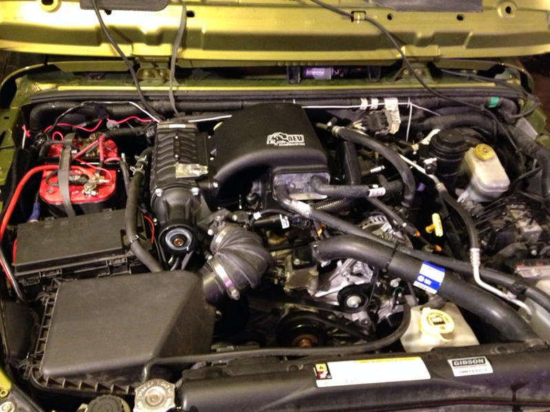

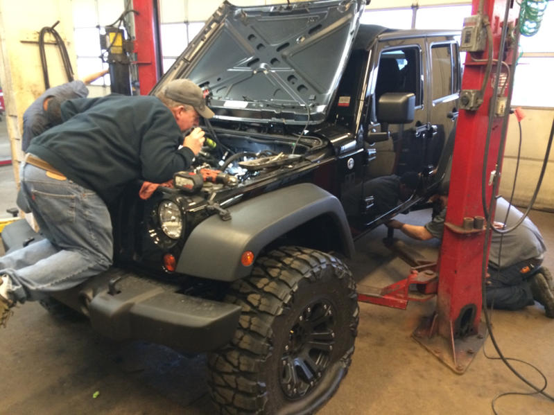

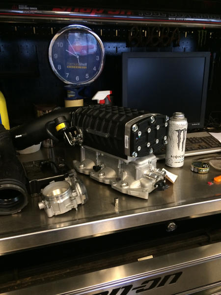

I just finished installing my Magna supercharger on my 2012 JKU today. I was hoping for a little more "seam of your pants" feel but overall I am pleased so far. I've already ready looked into a fogger kit for it. I guess I should remember is a 3.6L. Anyone else out there running one of these yet?

AlexjeepVb's Avatar
Joined: Feb 2010
Posts: 689
From: Virginia Beach, VA
Dam that blower looks nasty.

karls's Avatar
Posts: 2,873
From: 36* N
Ol boy on the front end there made the tire flat- no wonder you're not feeling the power. It should make your tires roll a little nicer at speed when you punch it.

I had a couple hours to mess with the Diablo tuner today that came with the Magnusen charger. This was by far the most frustrating part of the install. I've been playing around with the parameters a bit. I was disappointed when I found out I couldn't change the shift firmness at all. Of all the features, it was the one I was looking forward to the most (except the obvious tune). I did try out the 0 to 60 function. I bested at a 6.91. Not bad for 4 door auto with 37" Nittos. All in all pleased. I will take it to the dunes Friday and see if the investment was worth it.

I finally drove it on the highway to my office today. I was just cruising normal to see how it all felt. I am a bit disappointed. I do not think the mapping is all it could be. It felt like it was missing at different rpm points. I basically would take of from a stop at a typical driving speed, leaving my foot in the exact same throttle position and it was noticably hesitating anywhere between 1800 and 2700 rpm's depending on which gear I was in. It also held 4th gear forever and it didn't want to shift even after completely letting off the gas. It eventually would go into 5th / overdrive but it was odd and consistant. I am not sure if it is a Diablo issue or a Magnusen tune. I guess since Magnusen was the one who emailed me the tune after sending them the stock mapping, I am going to start with them on the issue. Day 3 and still hopeful.
I haven't heard of too many others with this kit yet but would love any others input or experience with the 3.6 Magnusen.
