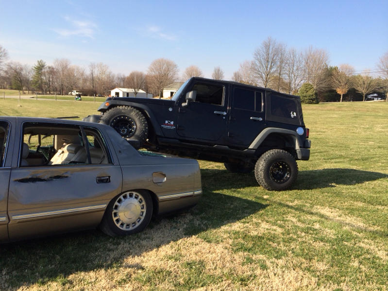

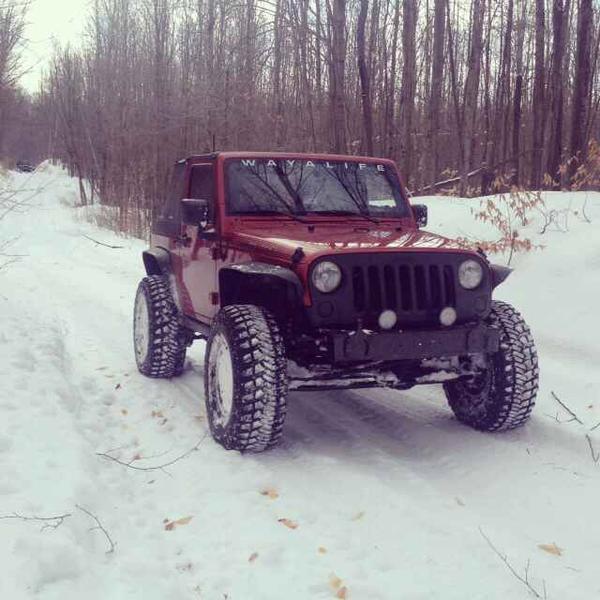

Here's my JK on 35/12.5/15

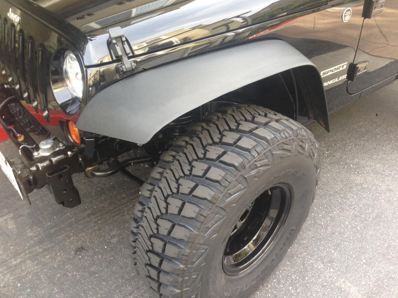

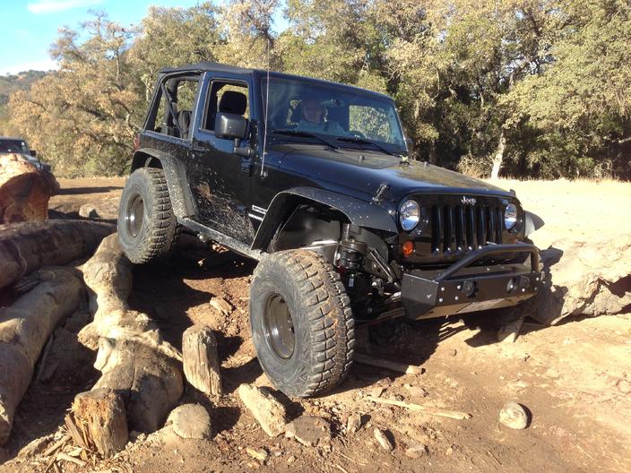

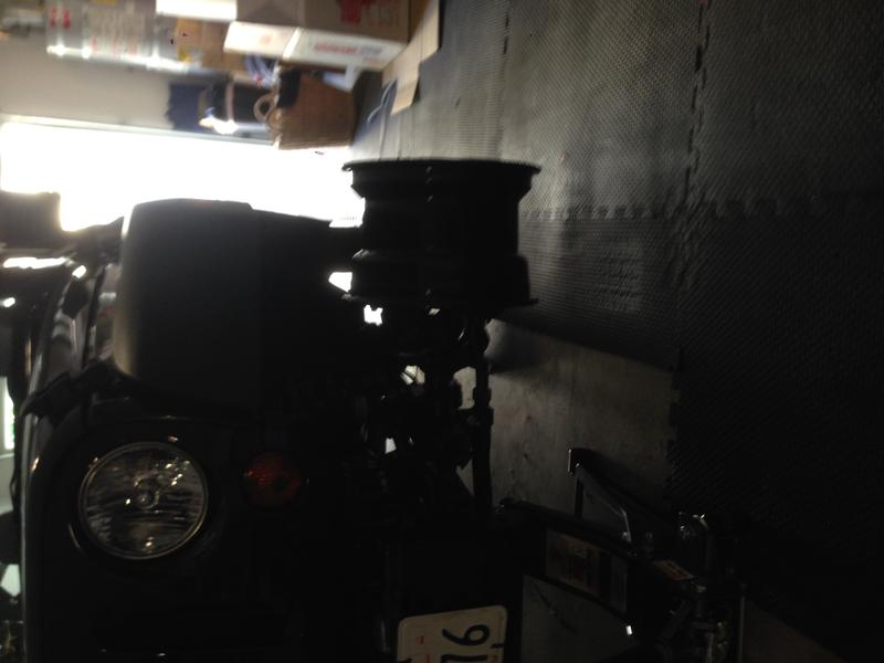

We've been running 10" wide wheels on our past 3 Jeeps. Main reason is that I wanted the additional width, plus I think the 12.5" wide tires flex better on a 10" wide wheel. I know some say that you'll pop a bead on the wider tire, yet we run ~12PSI and have never (knock on wood) had a blown bead.
I attached a couple of pics of our 15x10 wheels.

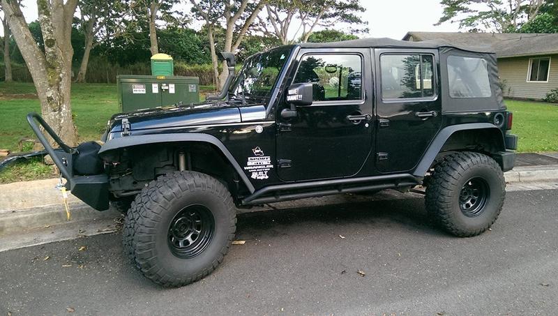

Here is mine on 15s. I love them twice as much when i air down to 12 psi.

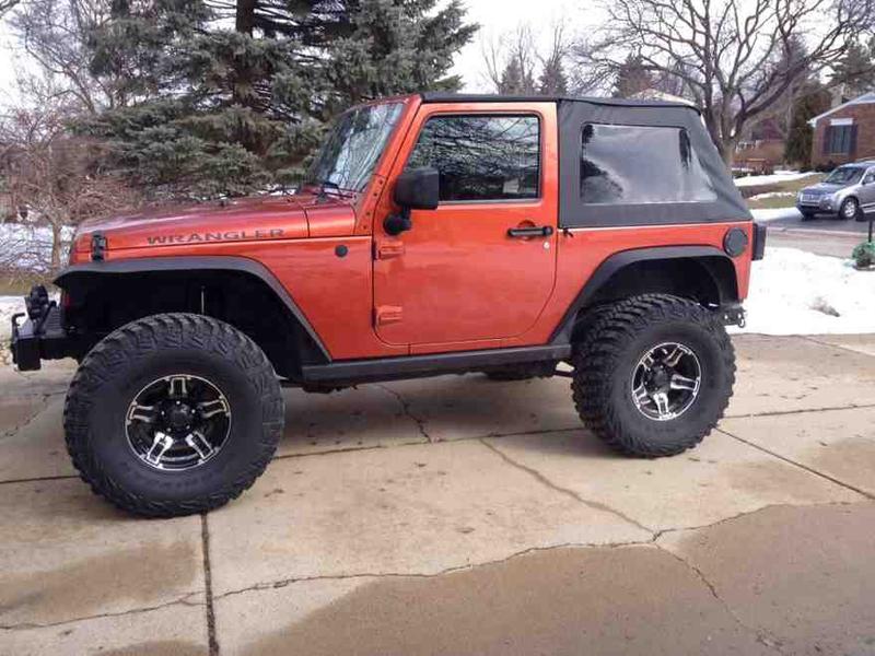

Here is mine. Procomp rock crawler with fake beadlock. 15x10 3.75 bs.
