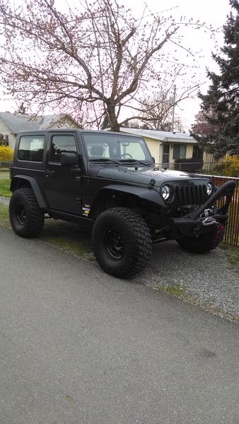

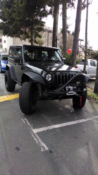

running 35" BFG KM2 on 15x8 MB wheels I am running this combo on a 2.5" Rubicon express coil lift.

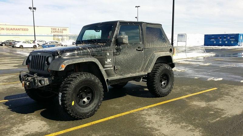

35/12.50/15 MTR/K on 15x8 MB Razors

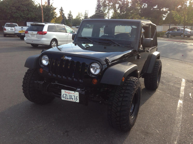

We've been running 10" wide wheels on our past 3 Jeeps. Main reason is that I wanted the additional width, plus I think the 12.5" wide tires flex better on a 10" wide wheel. I know some say that you'll pop a bead on the wider tire, yet we run ~12PSI and have never (knock on wood) had a blown bead.
I attached a couple of pics of our 15x10 wheels.
Those look awesome. What is that wheel and the backspacing? Did you do any modifications or did it fit good from the factory?

Thanks!
15x10 Pro Comp's w/ 3.75" BS
I have about 3" of lift from using Rubicon 19/60 springs and a 1" spacer in the front plus 1/2" in rear.
Here are some pics without the lift. It would have wheeled fine with bump stops to keep the tires from tearing things up. The trimming really opened things up!

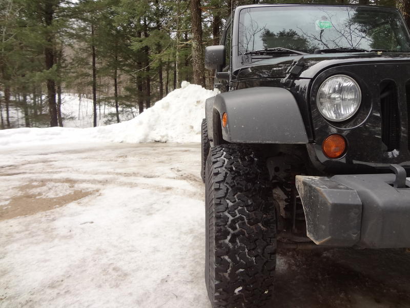

2010 Sport, 2.5" BB with 2014 Rubicon 19/59 Springs and Shocks, 35x12.5x15 BFG AT with MB Razors.

How do you like the Rubicon express lift? I was thinking of getting the spring and shock kit.
