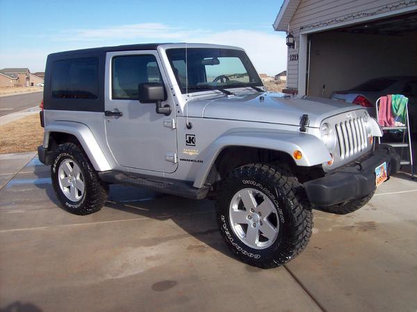

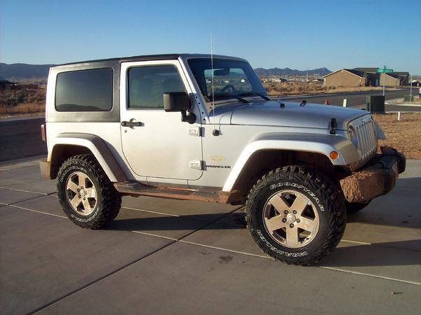

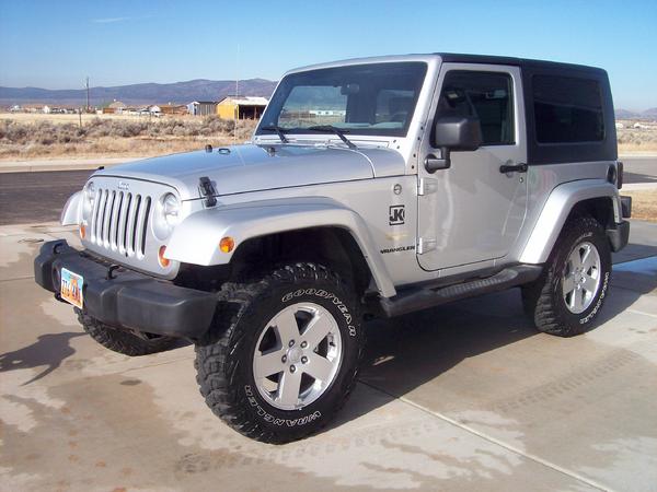

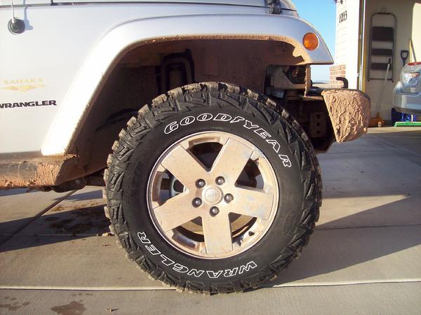

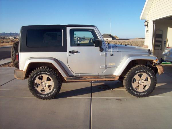

I'm running Goodyear MTR with Kevlar..33"s I have a leveling kit only. No spacers.
If you rub just adjust your steering stops with a few washers.

what size leveling kit do you have?

Check my signature...Its a Terra Flex...$129.00. It gives you about 2" up front and and 1" or so in the rear..Your Jeep will sit level once your done..it Looks much better and you get a litttle bit more suspension travel...You keep the stock shocks..
I think its the best bang for your buck if you going with 33's as it gives you Just a tad more tire room.
