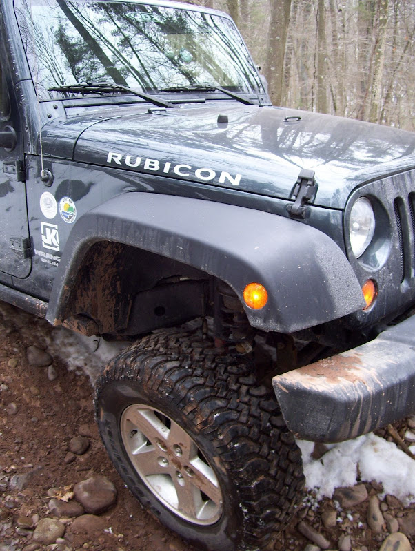

i've got an 07, so can't help you folks with the 08, but i did having rubbing on the rear links before i moved both to the inside of the swaybar till i get my 2" spacers.
I got my JK to almost full flex over the weekend:

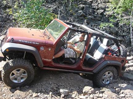

Default 07 with 2.5 and 35's
2.5 and 35's

NICE....
