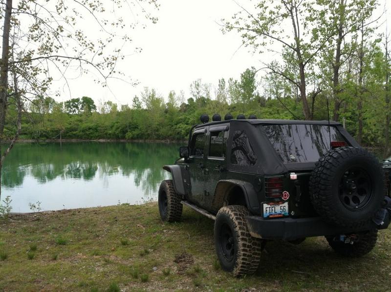

Love mine!!

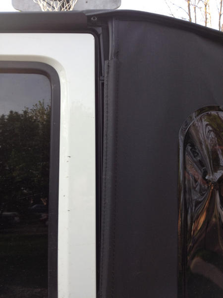

Just got mine last week here in SD. It's been pretty cool out still but wanted to put it on. I'm havin probs with the back door surrounds not fitting. Here's some pics.

Works best if you start all the zippers about 2 inches, then tuck everything in and lastly finish the zippers all the way.

Try putting those tongues in first, even before zippering the top zipper. Make sure they are snug a then do th top zipper. I had the same problem. I had little plastic wedges I used when installing our hard wood floor and used them to wedge the tongue in for a few heat/cool cycles so it would. Took them out once the top had a chance to stretch where needed.
