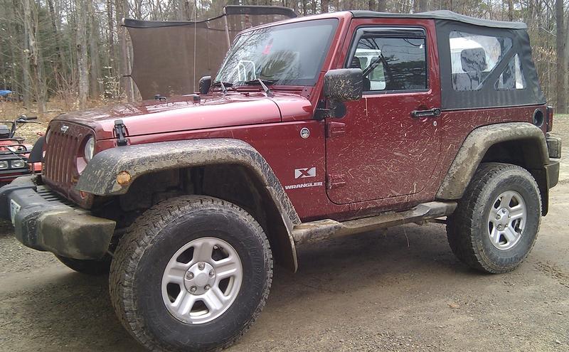

Covered it in snow on Saturday, put a little mud on it Sunday, and today - hosed it off, removed decals, and bobbed it.

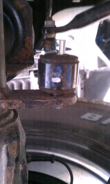

Made my own quick disco went to lowes and picked up a few items works perfect and was real easy and cheap to
I have done this. What you find out later it that these pins will rattle and bend after using them when they aren't tight, and There is a little bit of play in the sway bar so your Jeep will lean to the passenger side when no one is in it because of the gas tank. But if you plan on going wheeling the next day or so, these will work fine to keep you from laying in the dirt disconnecting and reconnecting.
The standard pins don't fit the metric sizes all that great.
