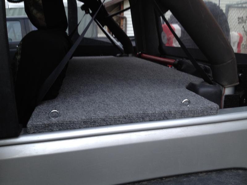

Originally Posted by GeckoTY
That's nice! how did you make it?
Cut a piece of 3/4" exterior plywood to fit. Covered it with the appropriate color exterior colored carpet and bolted it to the tube using eye bolts. That will give me tie down locations if I want to use it for carrying things.

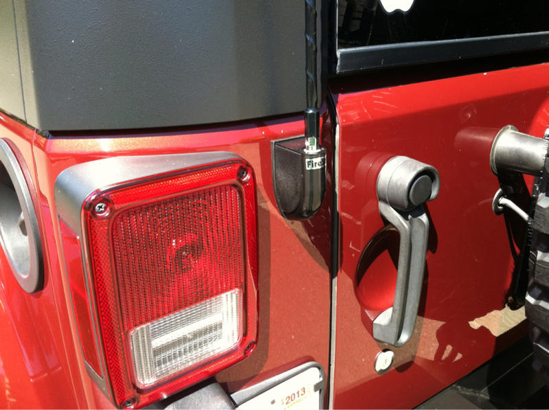

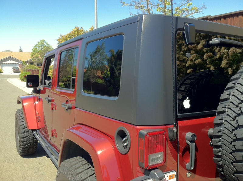

Cobra 29 LX; Arizona Rocky Road mount; Firestik M2 mount. Drilling holes and cutting internal tub structure had me concerned, but after the first hole it was all good.

SWR is 1.2 across all channels.

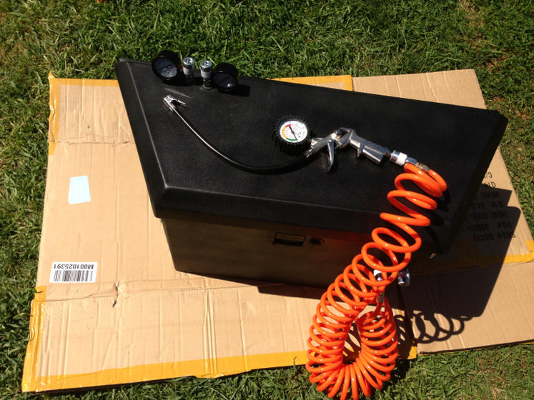

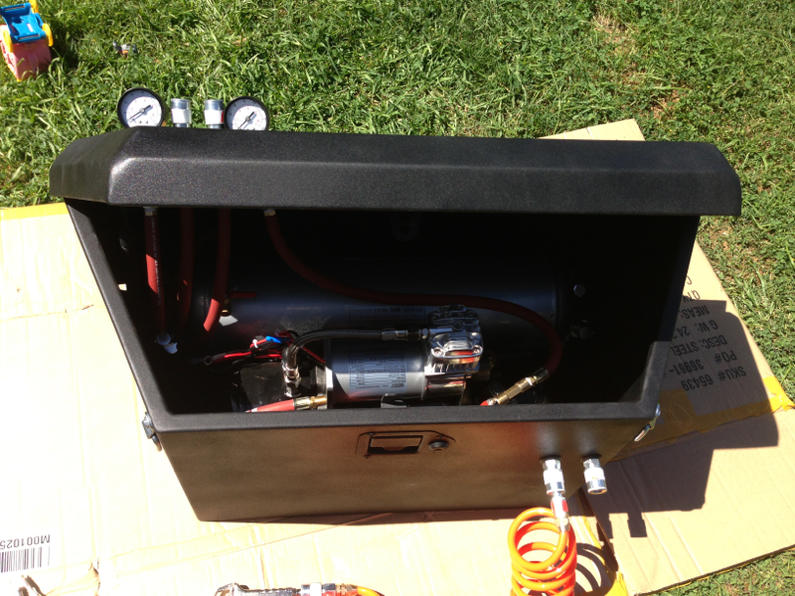

Making a portable, high output onboard air system. 2 air compressors, 1 2.5 GA tank, and 1 2 GA tank housed inside a steel trailer tongue box. Coated with bed liner.

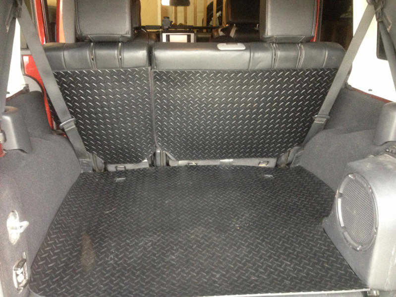

Home made cargo liner

That is a Arizona Rocky Road overhead CB mount. I was thinking of making my own, but decided to just buy one. They also give you enough wire with a 30amp blade fuse to go from the battery to the top of the passenger side windshield. I placed the power and coax outside of the mount just in case I have to troubleshoot.
Also notched the bottom of the Firestik M2 mount similar to the drilled mirror mod incase water finds its way inside.

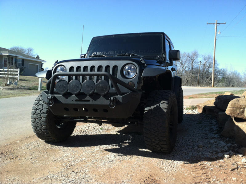

Lights......and bottom tint strip
