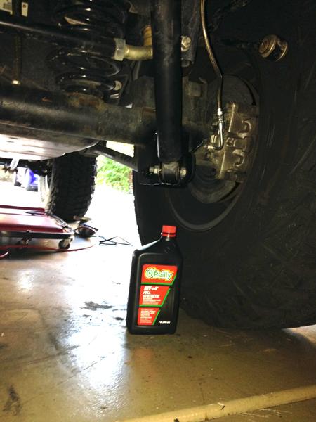

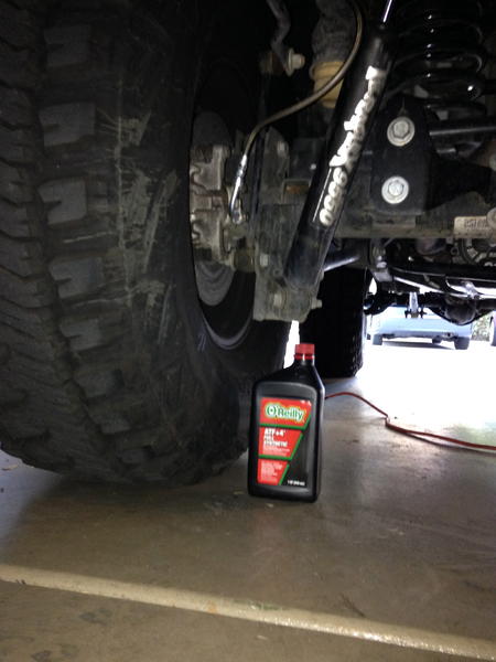

Got a new steering stabilizer.
Got this to hopefully help with bump steer on rough roads at high speeds.
Yes there is a difference in smoothness, but time will tell how effective it is at high speeds.
