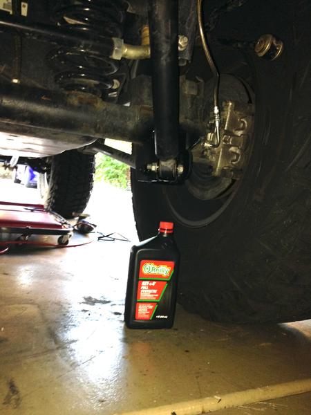

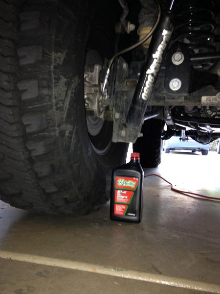

Originally Posted by D_engel
Attachment 508191
Attachment 508192
raised the rear lower shock brackets 2", chopped the LCA mounts, and ditched the rear sway bar
Very nice that's one of the things I do to mine front and rear....
Be sure if your not running Metalcloak or synergy progressive springs to use spring retainers. If you have 11.6"+ travel shock,s they will try and unseat.
Very nice job, looks good weld a slider on the bottom and call it a day rock ready....

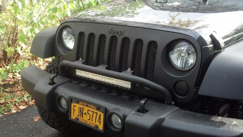

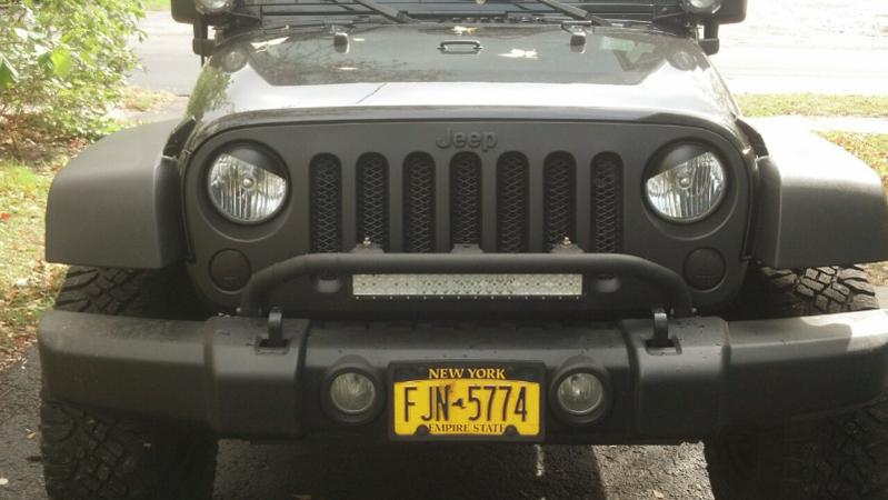

From: Potsdam, NY
Rugged Ridge grille insert, and Plasti Dipped my grille.
