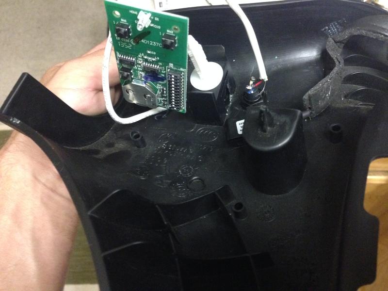

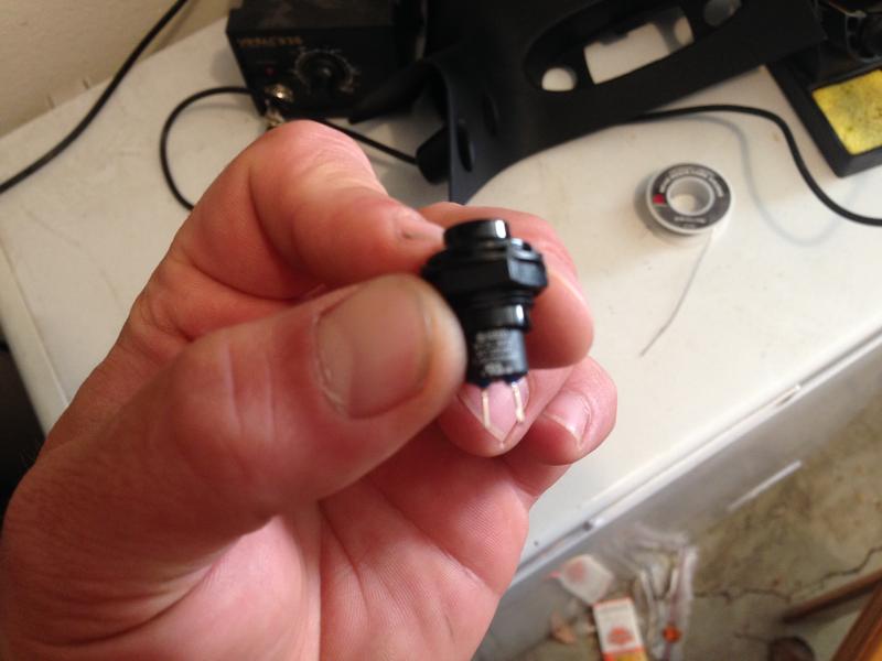

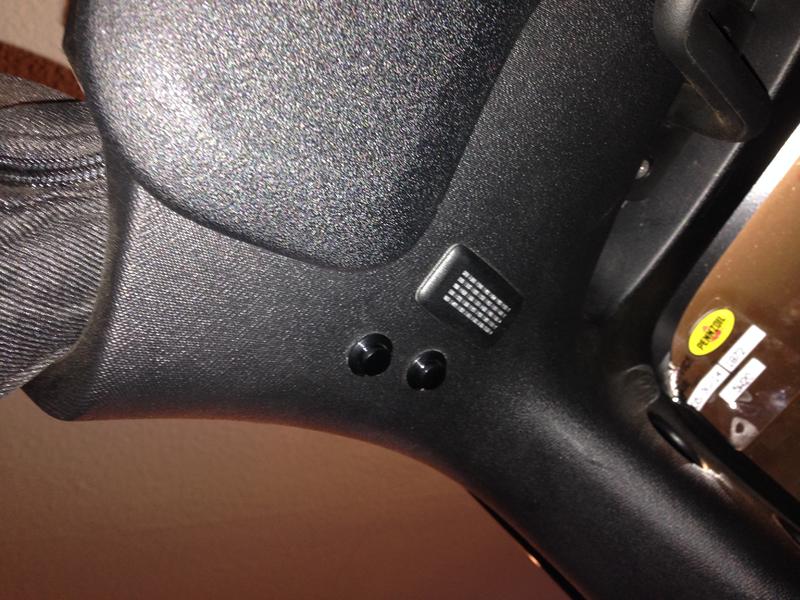

I gotta do a better job of taking pics of my mods as I do them. First I started with a Clicker brand universal 2 button garage door remote controller (KLIK1U). Then I took off the case and soldered some wire to the button contacts on the circuit board of the remote. This controller has 2 buttons (1 for each of my garage doors), so I did both buttons. I went down to radio shack and picked up 2 black push buttons (275-644).

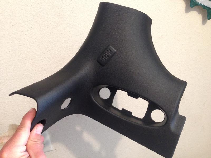

I removed the front driver side visor, then removed that piece of molding which was attached with just 1 fake screw body clip and a christmas tree type body clip.

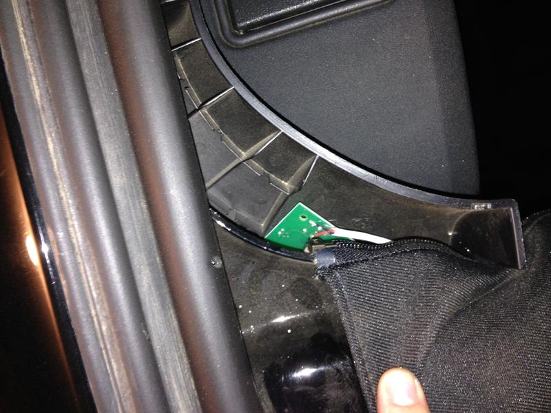

I drilled two 1/2" holes in the molding and installed the buttons, then soldered the push buttons to the wires coming off the buttons on the circuit board. Once I was finished I just put the Jeep back together and everything works great!

Theres padding on my roll bar so I just duct taped the circuit board to the inside of the molding and its just fine.
*I did this mod twice, once with a one garage door remote and the second time with the 2 garage door remote.

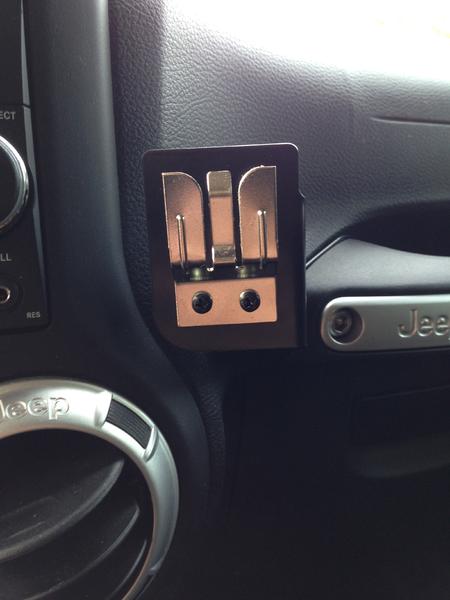

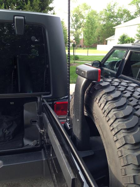

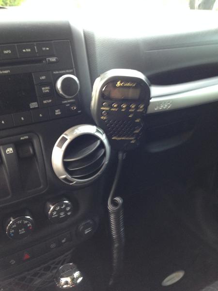

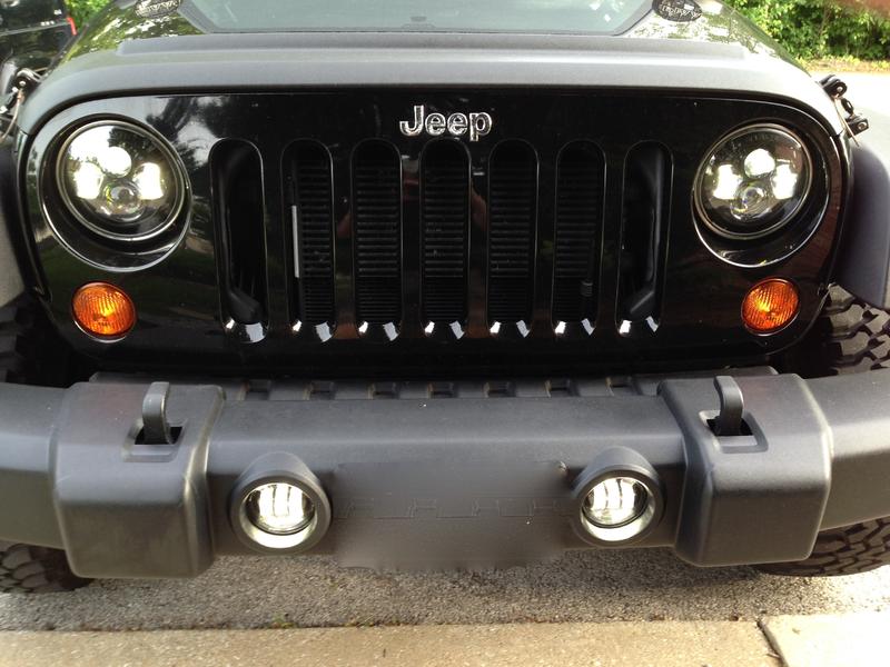

Installed JW Speaker Headlights, Fog Lights and Cobra 75 CB /w 3' Firestick antenna.
JW Speaker = Holy $H|T! What a difference between stock and these puppies (Night and Day).
- Headlights: 8700 Evolution LED Headlamp kit /w Anti-Flicker harness (connector)
- Fog Lights: 6145 Fog lamp kit /w wire harness adapter (connector)
Cobra 75 WX ST
- Teraflex tire carrier antenna mount
- VersaMount2 interior CB handle mount

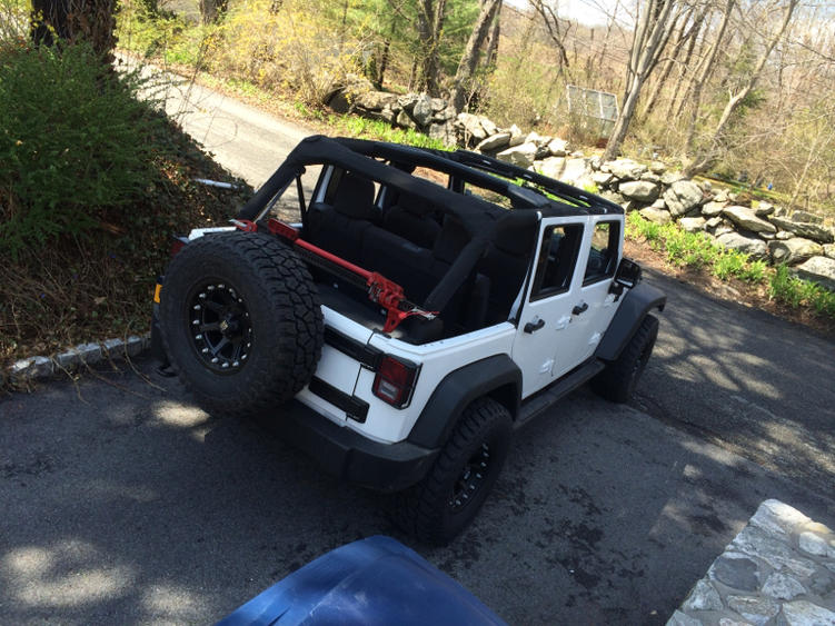

Aright so I have around $450 to put into the jeep but I'm not sure what to get... I was thinkin the E auto grille bumper below or trucklite headlights... Which one?? Or other options?? Here's a picture of my jeep now, pretty stock... Thanks in advance for opinions!

I was planning on trucklite until i saw JW Speaker on my buddies Harley... after seeing both up close, my personal preference = JW. Both are sweet lights and you can't go wrong either way.

I love my JW's wouldn't do it any other way great choice bud
