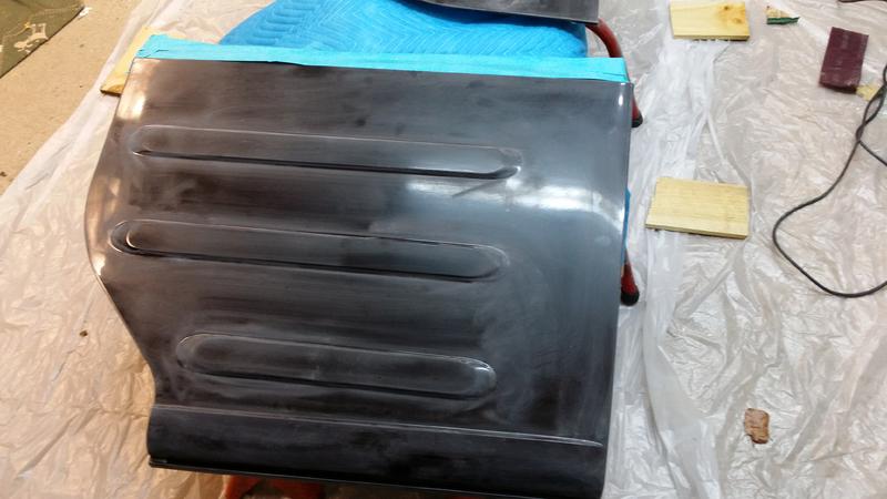

Default Bed Armored the the Top this week!

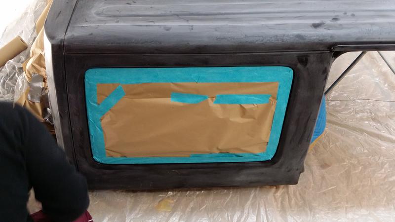

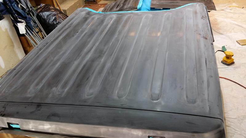

Last weekend, I was able to knock out spraying the top with Duplicolor Bed Armor. It took about 2 hours total with prep and spraying. I used a Shutz spray gun which was super helpful. You can see in the photos the method of prep. I was pretty committed to doing the prep perfectly.
I used a power hand sander with scuff pad to take down the clear and get a good surface for adhesion. I used Duplicolor Paint Prep and tack cloth for cleaning prior to spraying. There isn't much need to be particular about small specs and dust staying because the Bed Armor goes on so thick that you wouldn't notice anyhow.
I then shot the tops with two decent coats of the armor at about 50-60psi. I did them about 30 minutes apart... They suggest more time between coats, but I also planned to leave it in the heated garage for a couple days so I wasn't worried about total dry time.
I am super stoked with the results. The total cost me about $140 with prep supplies, armor, and the gun. My neighbor is going to do the same thing for the bed of his new Sierra, he was pretty impressed.
I will be doing this to the fenders, bumpers, and maybe the grill in the next few weeks. I am thrilled with the look. It gives it a very tough look.

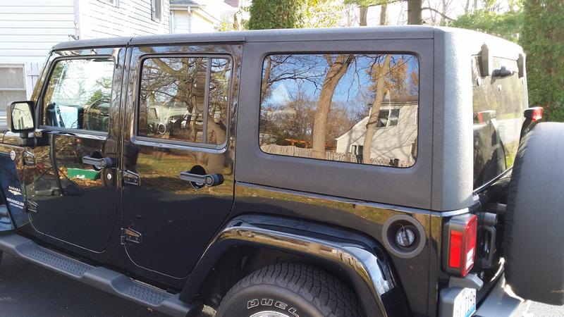

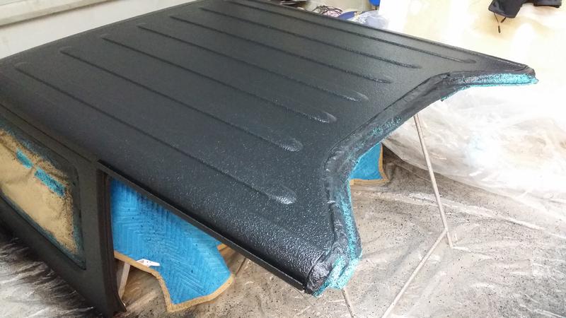

Default The results

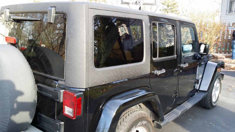

Here are the results from the Armor!

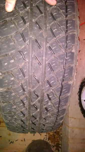

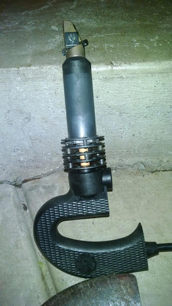

didnt want to toss the tires with 7/32 on them so used the ideal tire groover to gut the lugs for more bite.
