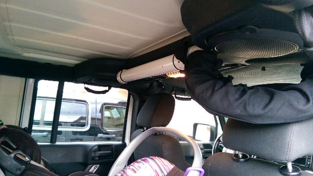

Originally Posted by xrayjeeper83
More info please?
2 1/2 inch occ from vent to plastic dryer hose . Since added this and it's awesome.

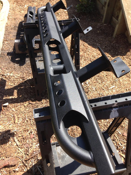

Sanded, washed, rubbed down with alcohol, primed and bedlined some used LOD sliders..
3 cans of primer, 2 coats
and 3 cans of truck bed liner, 1 good coat and a light 2nd coat.

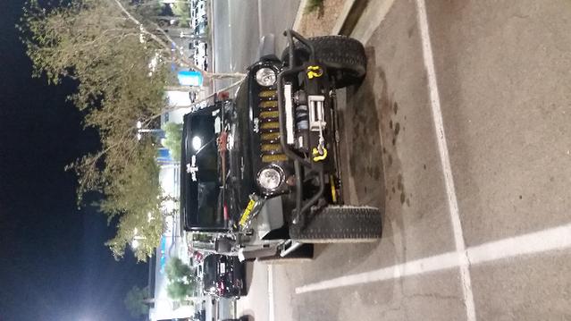

I ended up selling my 08 zombie killer for this big Blue Ox. Who ever had this before paid very good detail with suspension and upgrades.
