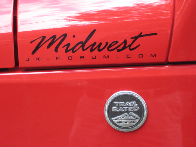

I ordered my JK forum decals and put them on.

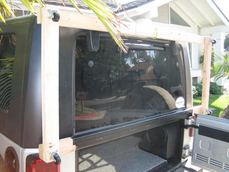

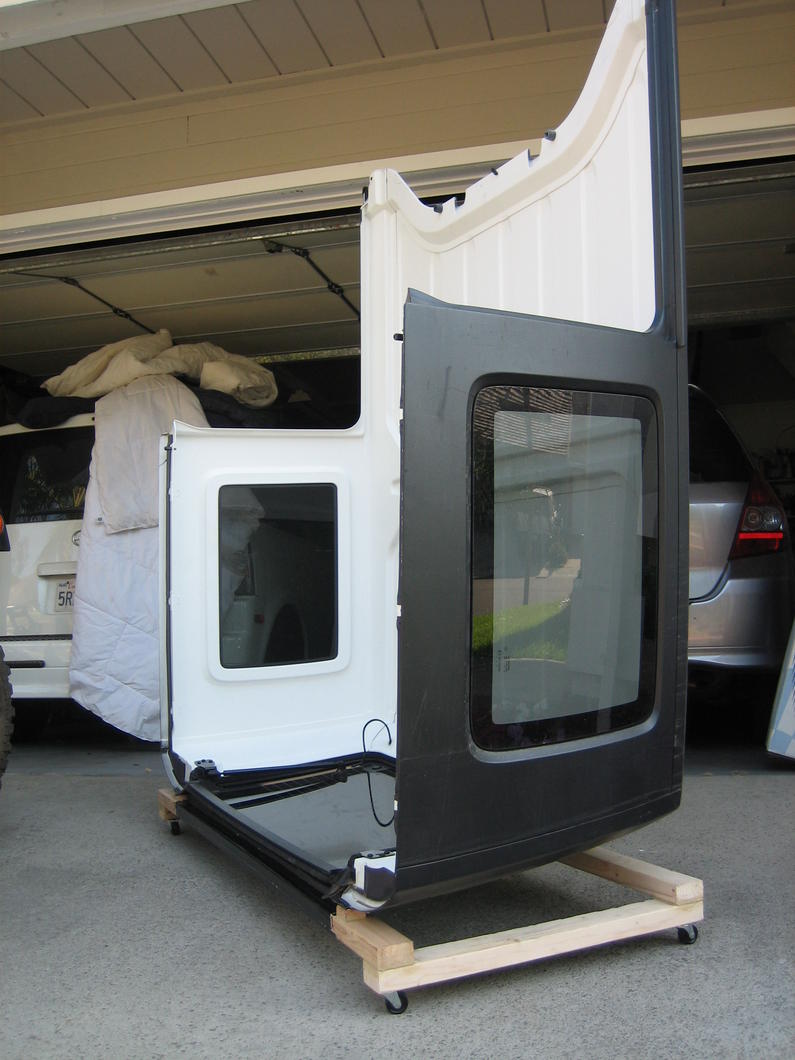

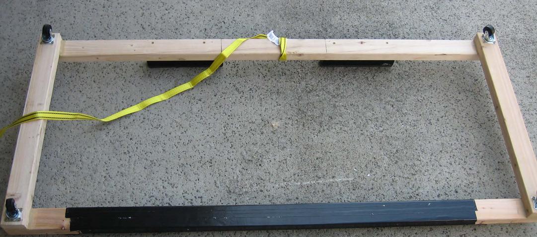

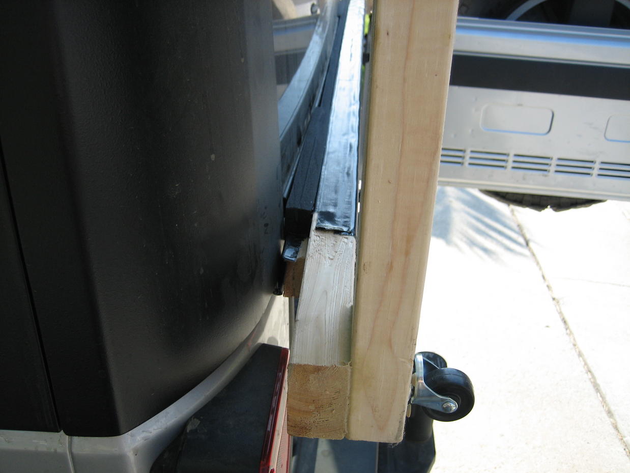

Default Hard Top Caddy
I was looking at ways to take off my top, and store it...and I found a cool caddy by Best Top. I didn't want to spend 200 bucks, so I made one. It clips over the lower section of the roof, and you cinch the top with a strap. That holds the rear window in place, then I get inside, stand up, and lift the top up and over the tire. With the caddy in place, I set it doen and tilt it on to the wheels. Cheap and useful!
