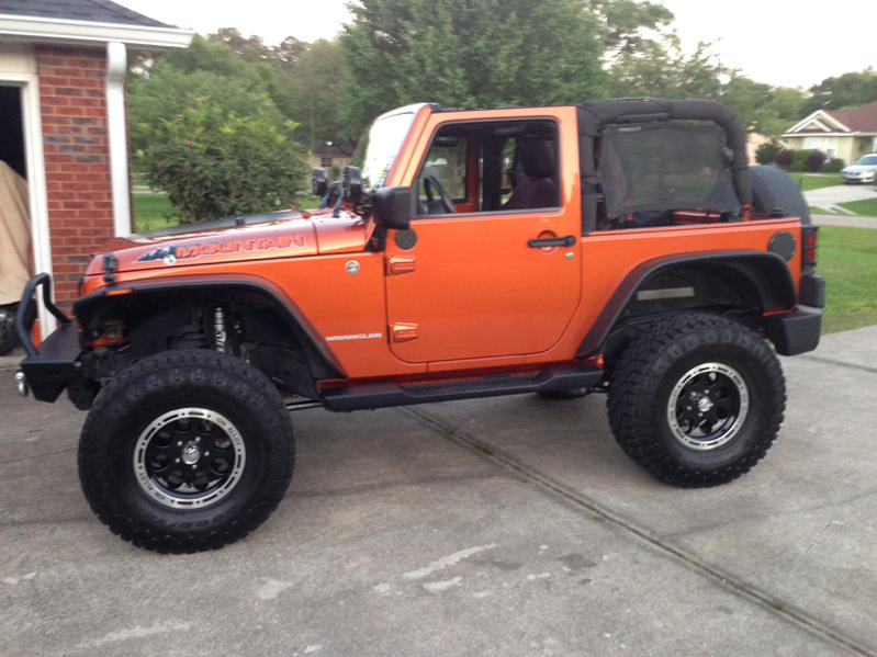

If you're running 33s I'd go with the 1.5. I have the 2.5 and run 35s. The lift is solid and rides well.

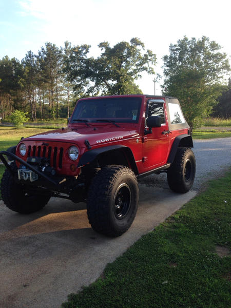

1.5 and 37s

Originally Posted by Flexer07
1.5 and 37s <img src="https://www.jk-forum.com/forums/attachment.php?attachmentid=562379"/>
How much lift did you actually get from those 1.5 coils and how does it compare on/off road to your previous taller coils?
