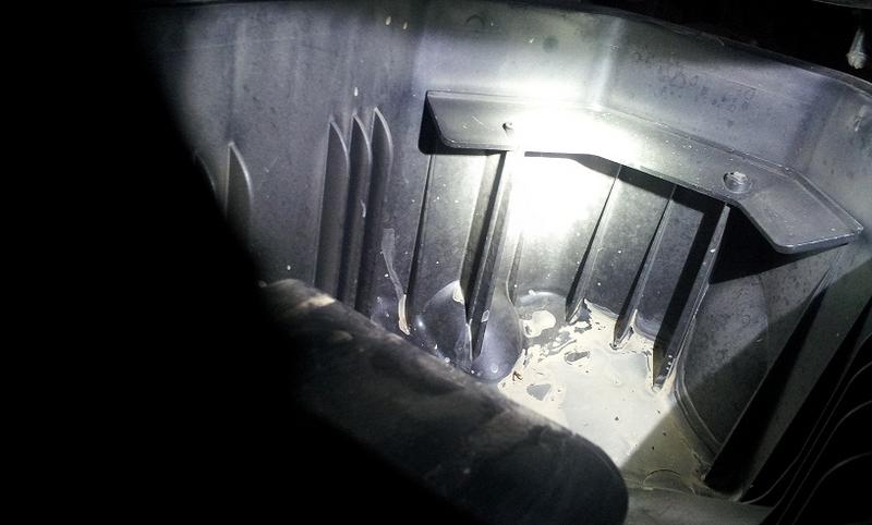

I went through a lot deeper than 24 inches. But the splash isn't was put water in the intake, it was the weep hole at the bottom.
After the water drained back out, it left the mud residue at the bottom of the air box. I got lucky, nothing happened.
