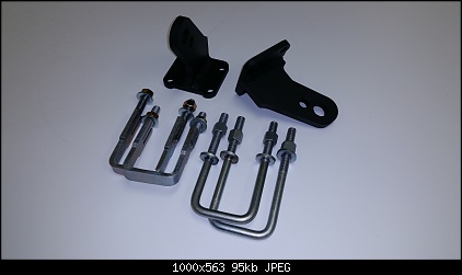

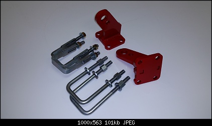

I found the Maximus-3 Jeep Wrangler JK Tow Loops. They look great...too great.
I just can't help but wonder if they will hold up to 1000's of miles behind the coach.
If anyone has used them, or has any thoughts on the subject, I am all ears. Maybe I am just being paranoid.

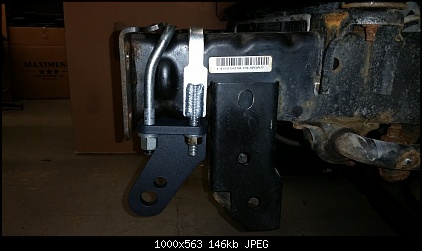

Back to what started this post, the Maximus-3 Tow Loops...I can't find a review for this specific part, but I also can't find a single negative word about any Maximus-3 products, especially in regard to to tolerances, welds, structural integrity. I saw one person say that his Blu-Ox connection wasn't just right, but when I talked to Maximus-3 and Rubitrux, they said the loops fit both my Falcon 2 Bar and the Blu-Ox (they have one pictured) bars....I like this set-up, and may just order it, and test the fit with the bar before I install them.
